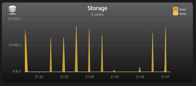

This is where the performance issues arose.  Yesterday, with the permissions set to Public, Time Machine finally started copying the data, but at a snails pace.  I am able to easily transfer 40MB/S to the other media shares without an issue.  With the iMac Time Machine backup, it is taking days to transfer 15GB...  I have tried to change the following settings as per other forum posts:

Am I missing something here?  The iMac and the unRaid are directly connected to the network, so I don't know what is going on.  The Storage transfer speeds are very spiky... I was expecting to see a steady stream of traffic to the unRaid....
