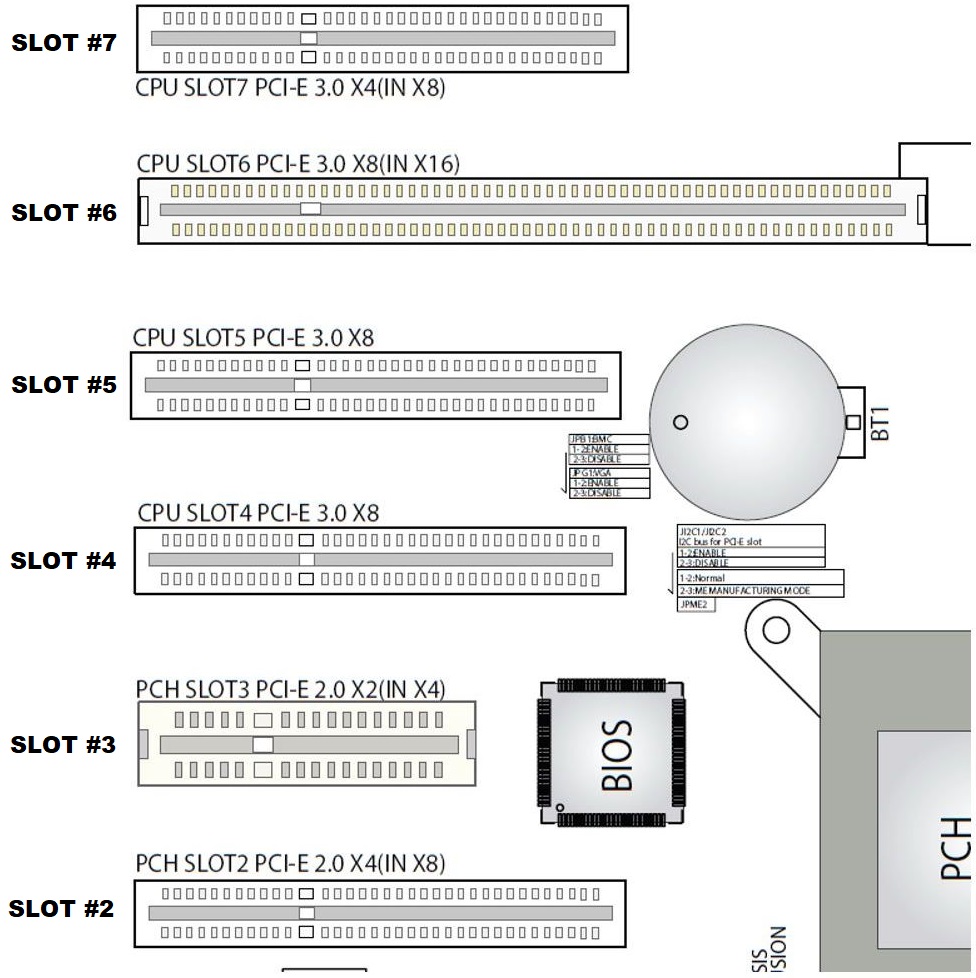

The graphic below is from my SuperMicro X10SRH-CF Motherboard Owner's Manual.  As you can see it has both PCH (Platform Controller Hub) and CPU labeled PCI slots.  Does the UnRaid OS work better with my Mellanox MCX311A-XCAT card by inserting it to the PCH PCI slot or the CPU PCI slot?  In short, what is the best PCI Slot Number I should use shown in the graphic below?
Yes
Always use CPU PCIe for best performance, usually lack of slot or IOMMU group issue will use PCH PCIe
Thanks for your post.  It looks like my choices have narrowed down to using either Slot 4, 5 or 7.  Slot 6 looks like it is for video card use so that one is out of the picture.   Thanks for your help.
