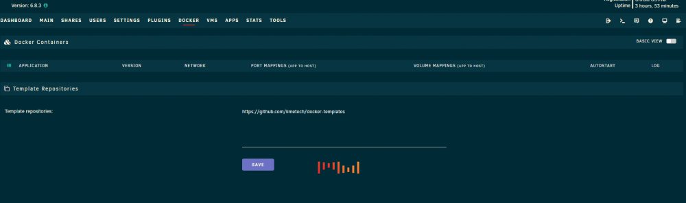

this just started happening. and docker wont load can anyone help
26 minutes ago, Squid said:
What do you mean by "won't load"?

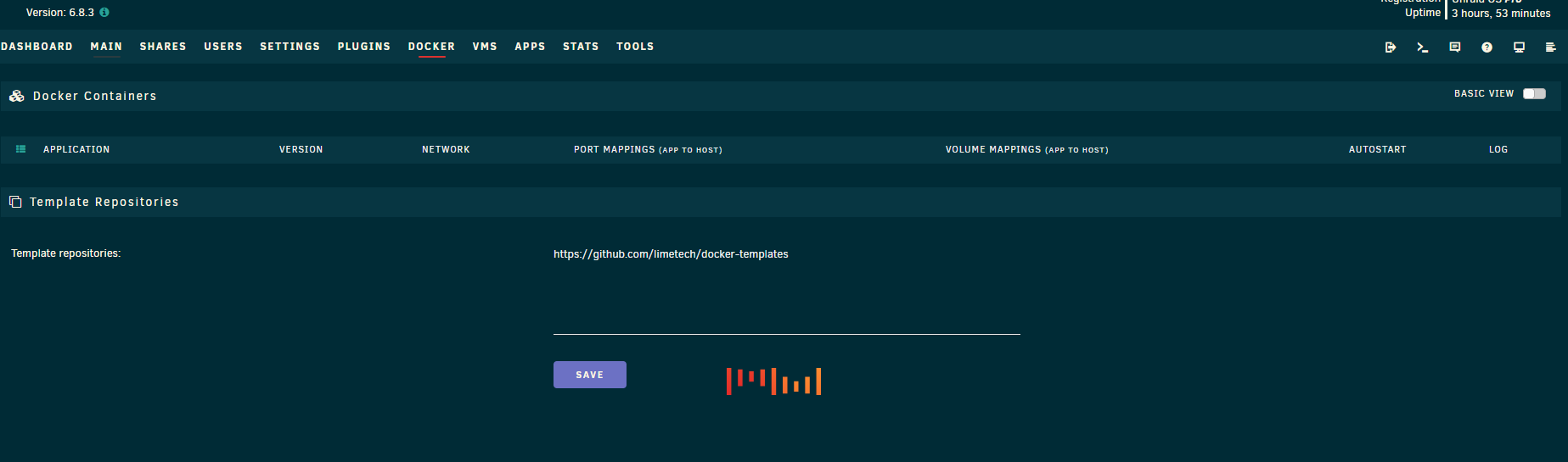

 stuck like this on the dashboard for 3 hours. it was fine the other day and i havent changed anything. maybe some container updates. the actual dockers are running like plex for example
Ok.  Post your diagnostics.   Also, vast majority of the GUI is coded such that if it doesnt load with exactly 120 seconds it will never load regardless of how long you wait.

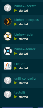

although my icons are missing. missing before to be fair. any ideas?
Assuming you're on 6.8.3+, missing icons would mean that for whatever reason the system was unable to download the icon.  It'll keep retrying every time you hit the dashboard or docker pages.  But, you may have DNS resolution issues and need to set static DNS addresses (208.67.222.222 / 208.67.220.220) in Settings - Network

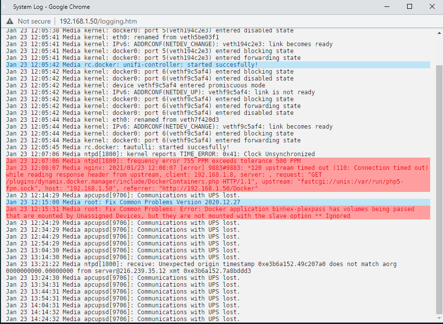

fml the loading issue has happened again. please see diagnostics attached
media-diagnostics-20210126-1342.zip
The fact that you feel you need to give 100G to docker.img is a pretty good indication you have done something wrong somewhere sometime. 20G is usually more than enough, and making it larger won't keep you from filling it, it will only take longer to fill. I have 18 dockers using less than half of 20G.
changing the DNS to the addresses above worked. However its been fine all these years with googles dns no idea what has changed
