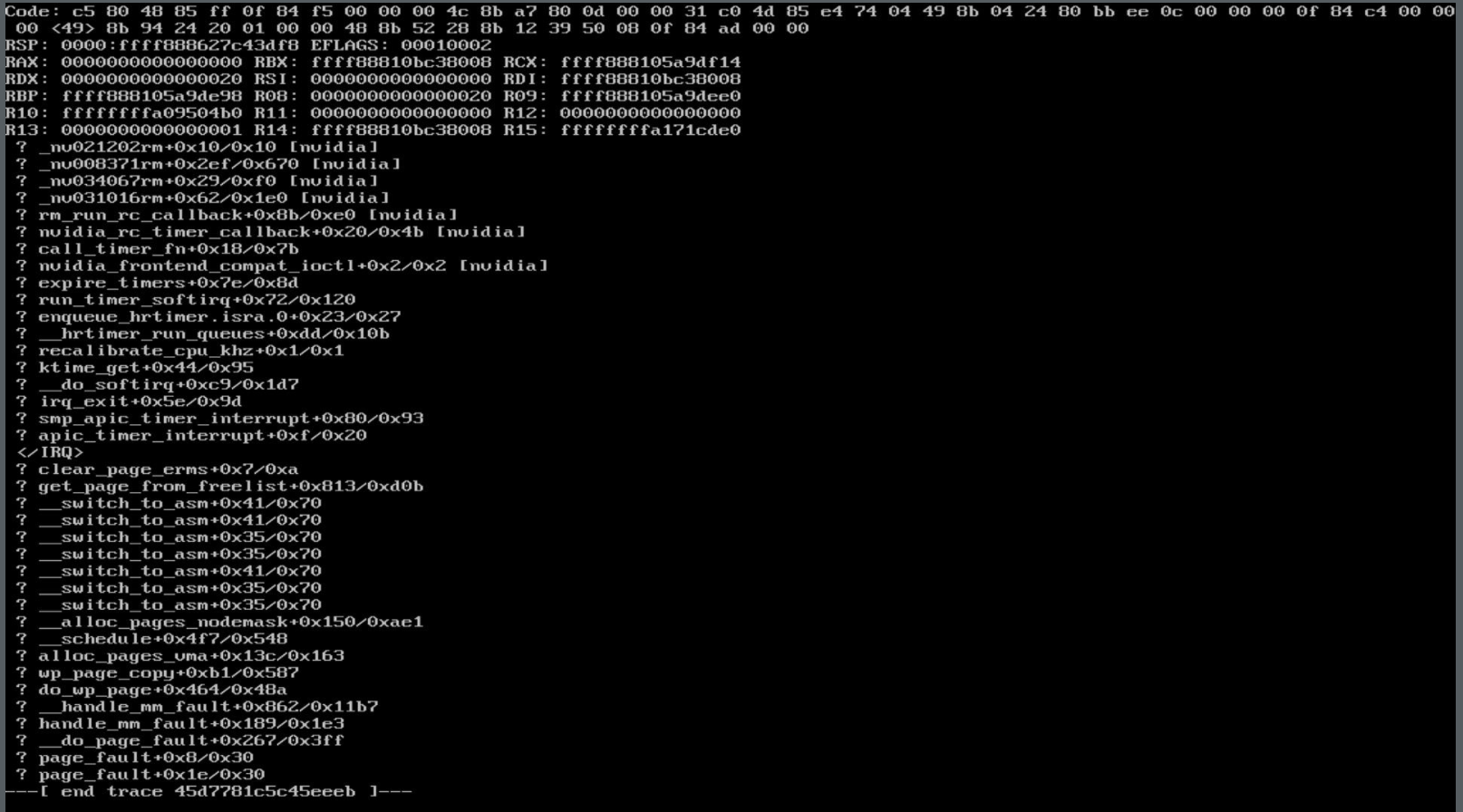

So within the past month i've been getting weird crashes at pretty random times, all I can tell is that it relates somehow to a network issue. The only way I know it has crashed it because when it does it causes my powerline adapters (renting so can't run wired ethernet :() to 'crash' and will loose their connection to each other and will keep doing so until I unplug the server from the network or kill power to it. Checking the console after it has crashed shows me this.
After doing some digging after the first couple of crashes I set up the syslog server to monitor it, around the time of todays crash this is what the system logged.

I've got no idea and can't dig up much info, any help would be appreciated.
Diagnostics also attached.
odin-diagnostics-20210123-2256.zip
If that's all that's logged not much to go on, those are normal, if there's nothing after that the crash is most likely a hardware problem.
