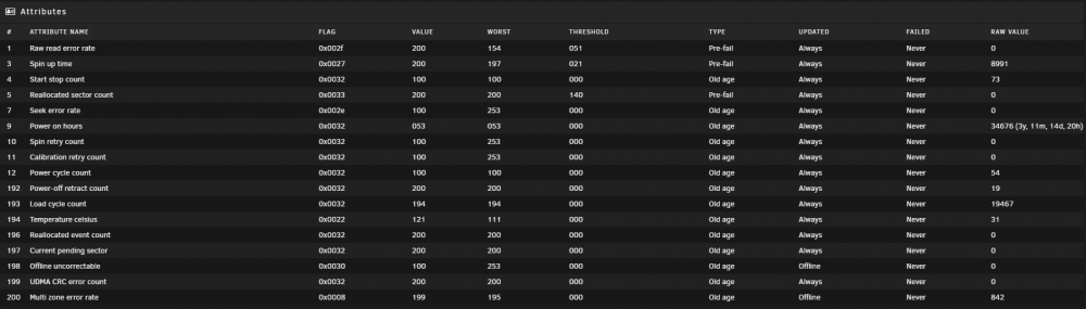

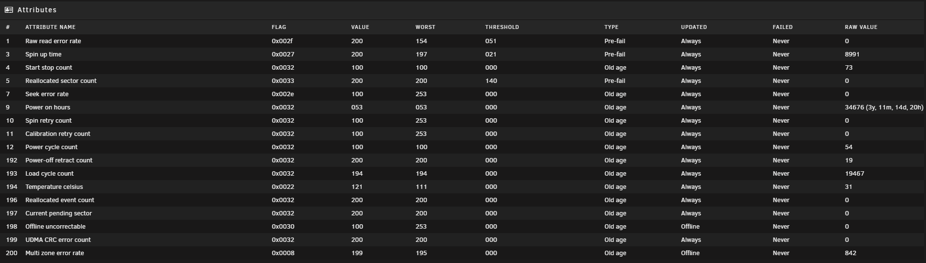

Full Smart Results shows a few errors though
Edited by ehrw
Adding full smart info
SMART is showing some issues, it will likely fail again in future, but difficult to guess if it will be tomorrow or a year from now.
