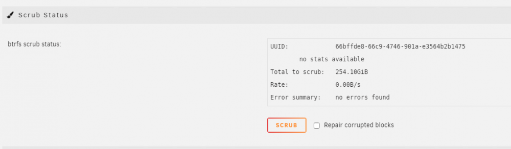

You can run the scrub by clicking on cache on the main page then scroll down to the scrub section.

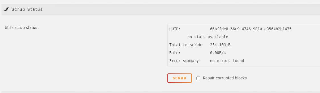

Need to click on cache1, then:
Ah! That was absolutely my problem here.
Okay! I began a scrub with "repair corrupted blocks". Since I have two 500 GB SSDs, I imagine my slow CPU might take awhile.
