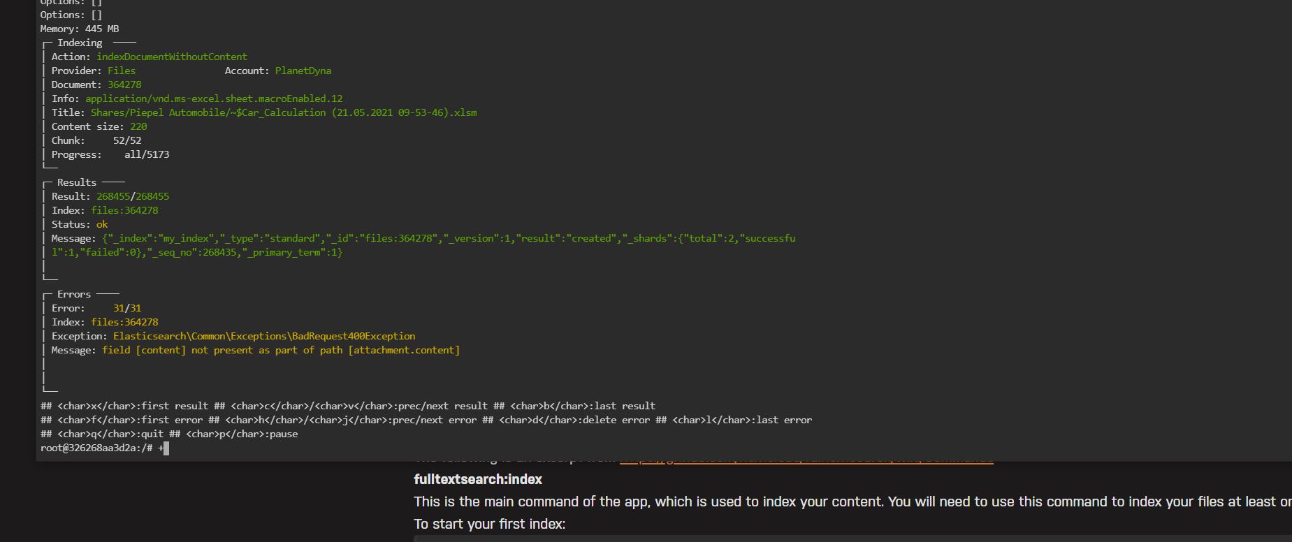

June 12, 20215 yr Can someone tell me whats wrong here? Test is running great - but no results appears in nextcloud search.
