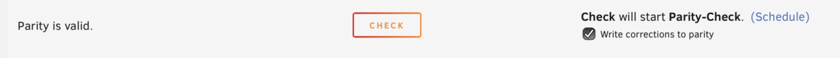

A few sync errors are normal, even expected, after an unclean shutdown, just run a correcting check.
Like this ?
Thanks !

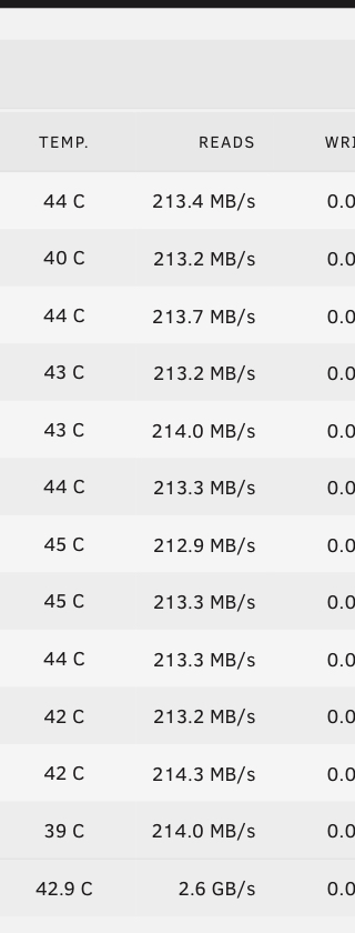

totally unrelated but are those reading speeds normal ?
Looks right for the disks you have, it will slowdown as it goes to the slower inner tracks.
