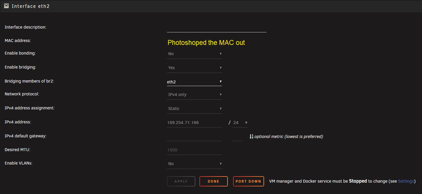

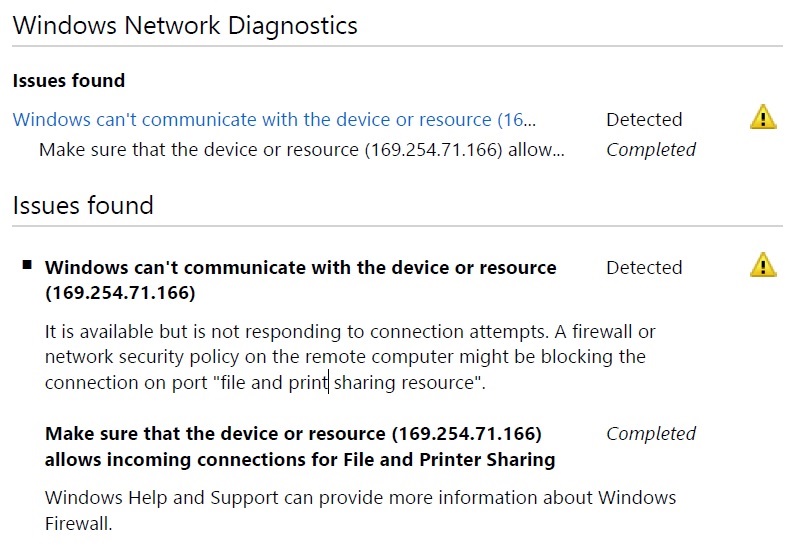

Below is the report I got from my Windows PC after I ran a Troubleshooting wizard.  It seems my Windows PC detects the Mellanox card but in cannot communicate. Also below is a screenshot of my UnRaid Network setup for my Mellanox card.
Can some kind person in the community please help me configure my UnRAID PC so it works correctly with the Mellanox card?  What parameters do I need to change in my UnRAID system so it communicates with my Windows PC?   Any advice will be greatly appreciated.  Thank you.
21 minutes ago, slipstream said:
The IP I am using on both PCs is 169.254.71.166
IP must unique in a subnet, can't be same, change in Unraid to other IP.
I probably wouldn't pick an address range typically used by APIPA either

Problem not relate IP is ".200.1  and .200.2" nor ".11.199  and .11.197". You just need use "ping" to check does both end can communicate each other.
The issue is you use host name to access SMB share "\\hostmane", so this add extra factor on top. People always mess up by Windows "odd" behavior i.e. credentials / workgroup ... etc, I never use hostname for access share, just direct use "\\ip.adress" to make things simple. Pls ignore Windows network diagnostic, it almost useless.
Pls spend more time on learning Networking / SMB stuff, this is my best advice.
