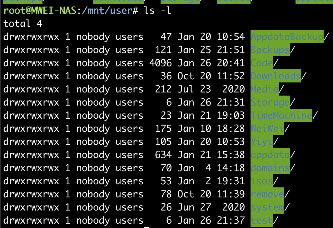

All was working fine until I clicked share tab, and noticed the all my user shares are gone. While they were unseen, all the data are still properly stored on the disk (I can still see /mnt/user/ folder and all its sub folders). But the network devices couldn't find any user shares either previously exported from nfs or smb.

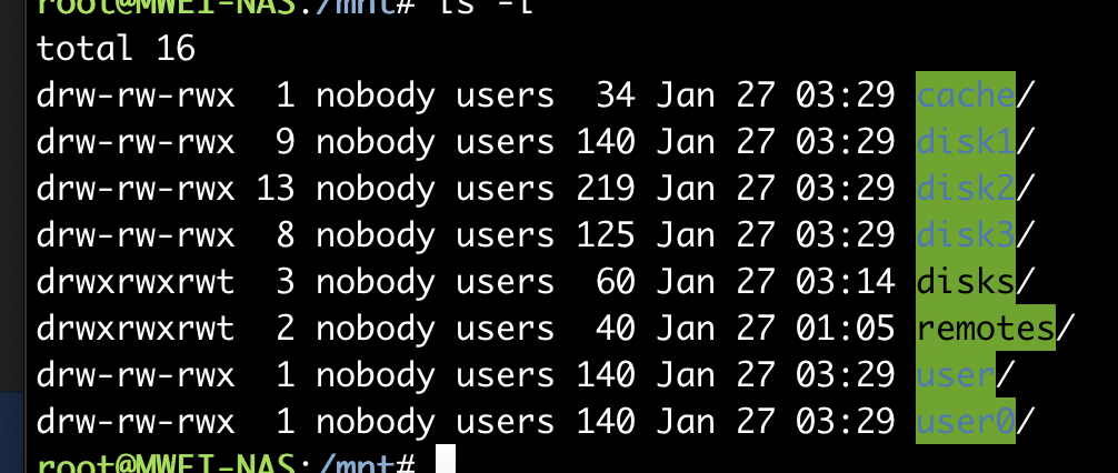

Those look OK but what about a level up from there, /mnt ?
No that's wrong. Don't know how it got that way. Have you tried rebooting?
@trurl
Do you know what are the expected setting?
Perhaps, I accidentally “chown” them. I tried umount the user and user0, and then “rm -rf” to see whether the system would regenerate them back. It looked like they were recreated, that is the default settings came up after starting the array.
Also been rebooted many times both in normal and safe mode, but no difference.

Appreciate your sharing. It looks like the user and group execute permission are missing from those folders on my server.
I don't recall me purposely updating them. I will give it a try to make up the grants like yours anyway. Stay tuned.
Bingo. Hats off to @trurl
I granted the gu exec permission.
The shares came back on right away. The permission is well preserved too even after I restarted the array.
