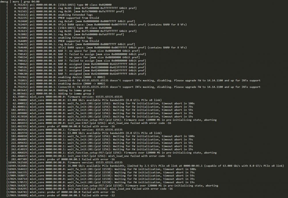

now I'm using unraid 6.8.2, few days ago I bought new pcie device : Mellanox ConnectX-4 Lx MCX4121A-XCAT with dual 10G network,
then I found it doesn't work in unraid, I use this cmd to look for detail and I successed
dmesg | more | grep 04:00
the msg shows me system couldn't identify the device's firmware which is 14.28.2006, unraid just allow fw below 14.14.1100.
the I go to Mellanox.com, the eralyest fw version is 14.18.2000, I've tested and failed again.

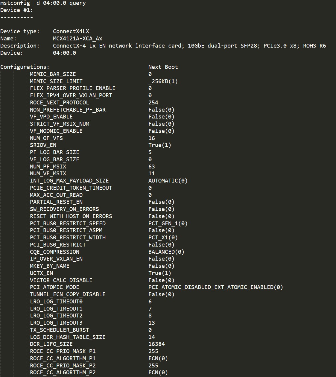

Is the adapter in InfiniBand or Ethernet mode?
The adapter have to be in ethernet mode to work, have no problem with my Mellanox ConnectX-3 (it also uses the mlx4_core).
mlx4_core             270336  1 mlx4_en
EDIT: I also have to say I'm on 6.9.0RC2 and have my Mellanox Firmware Tools Plugin installed (you should be able to switch between the modes with this tool and also to flash another firmware).

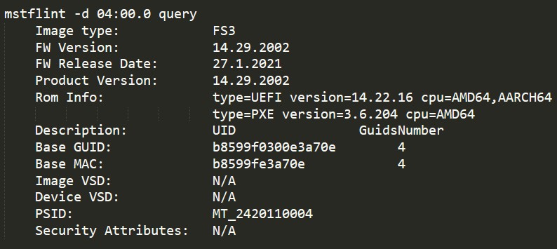

I've tried burn in these firmwares:
14_17_2020
14_18_2000
14_27_1016
14_28_2006
14_29_1016

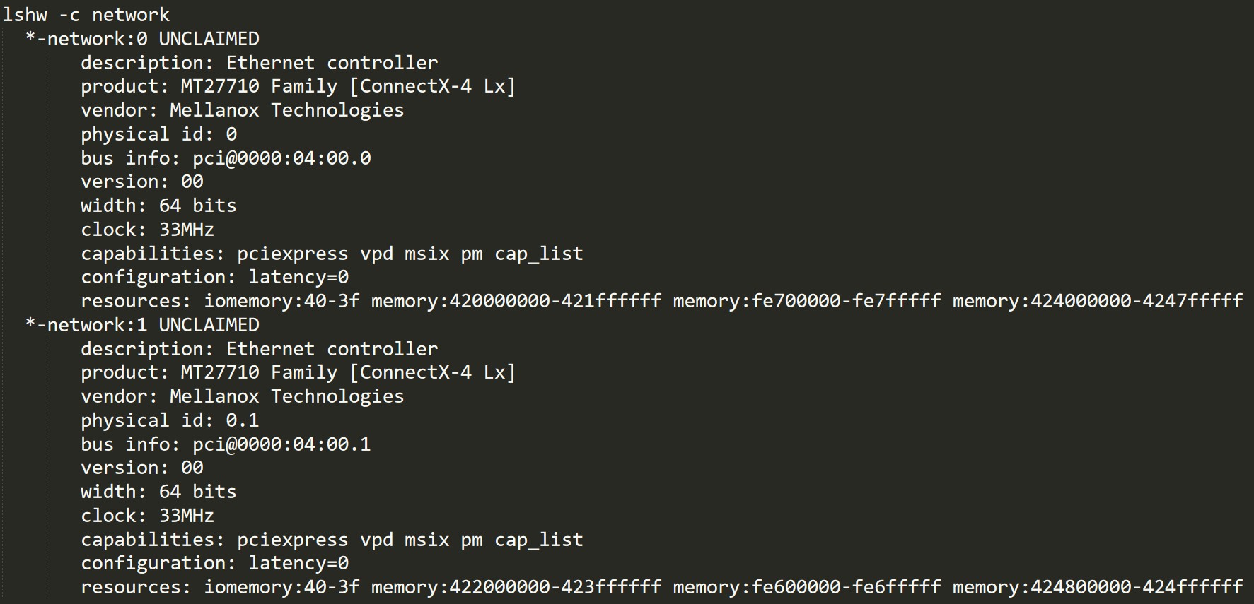

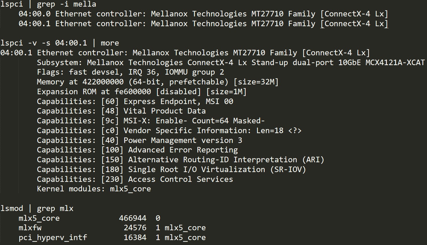

It shows me the same error msg, and I use lshw to check device's status:
lshw -c network
There's no valid driver works , just like my video card (HPE Mircoserver Gen , AMD x3421)
Something funny that the device isn't running by driver : mlx4_core & mlx4_en , but by driver : mlx5_core

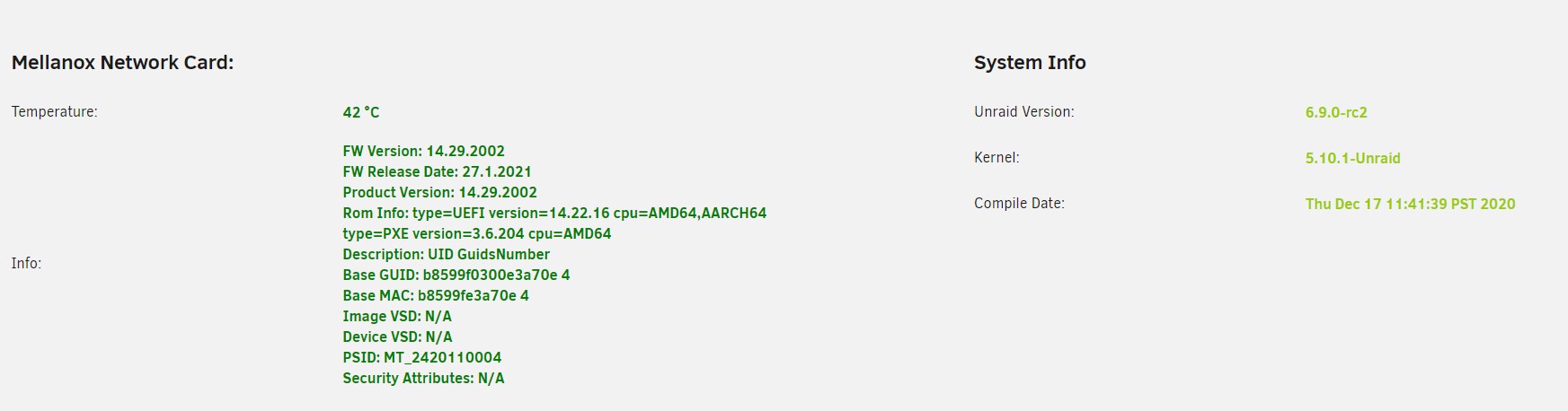

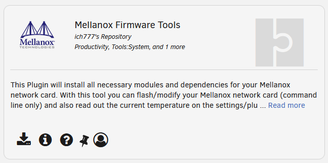

You mean if I update to 6.9rc2 then I can install this MFT from mellanox official? because I didn't see it in Community Applications
2 minutes ago, stepehn311 said:
And this Adapter is always working in Ethernet mode.
I think this adapter has two modes or am I wrong one is InfiniBand and one is Ethernet.

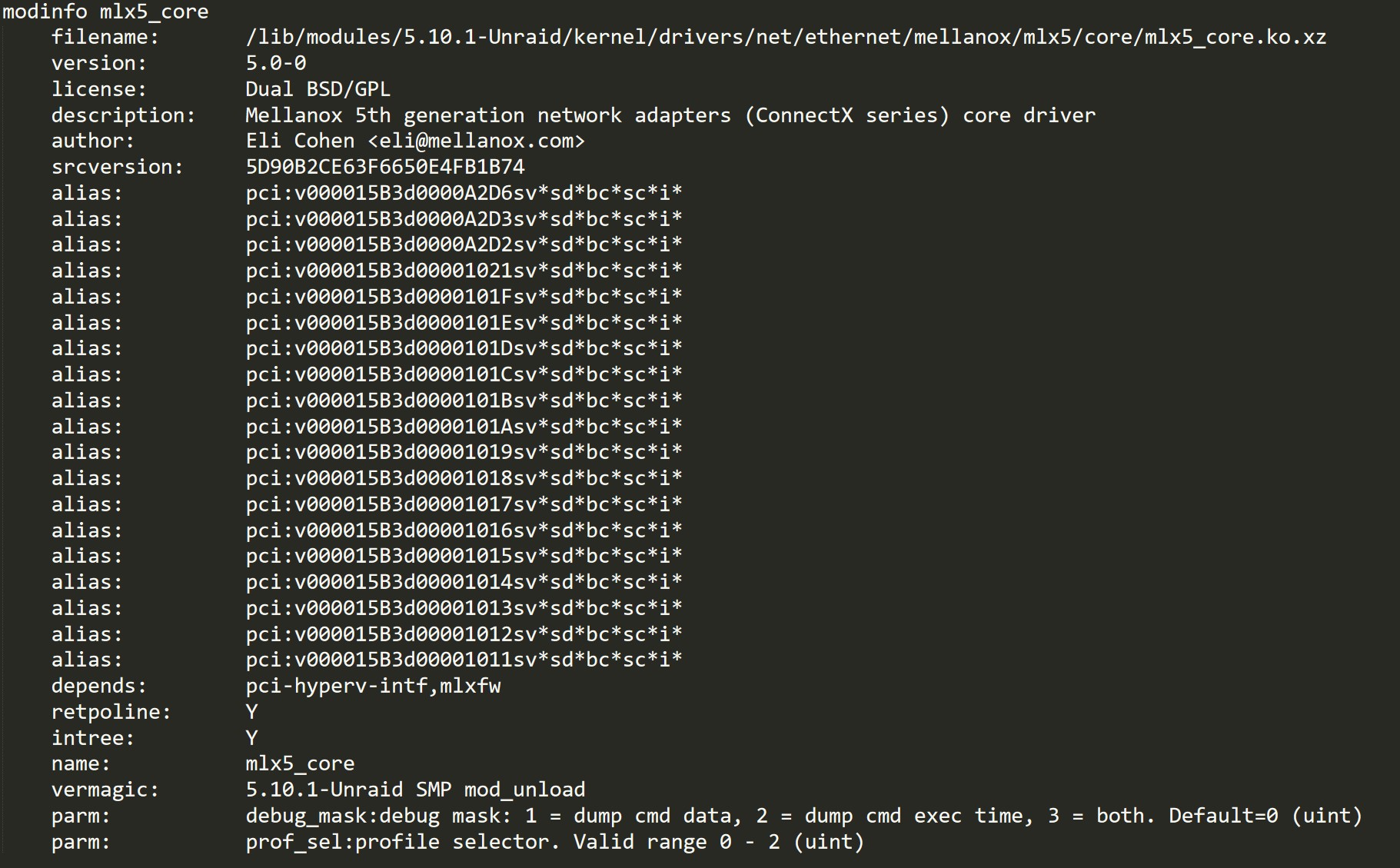

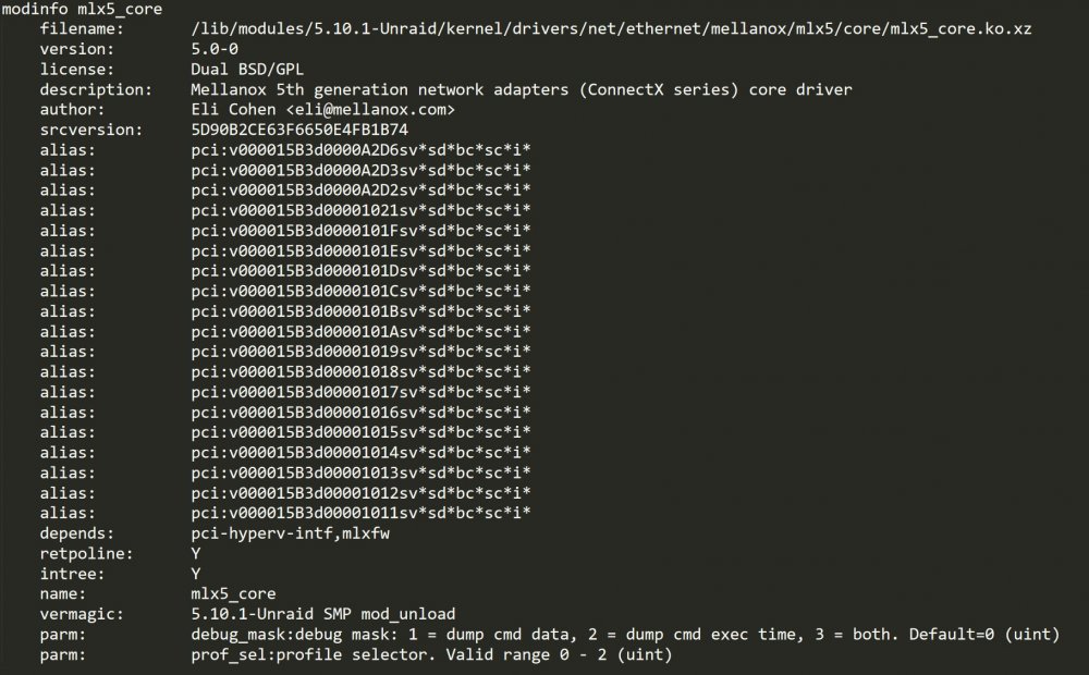

You have to upgrade to 6.9.0rc2 first then you will see my Plugin in the CA App, these are the open source MFT tools that I compile for every release of Unraid (then you can access the Mellanox commands from Unraid itself):
