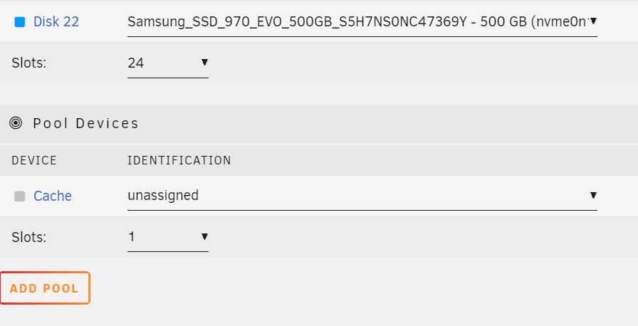

Upon restart, I noticed that a Clear operation had started automatically on my Cache disk which was also moved into my array in the last position (Disk 22). I reassigned the SSD to the Cache drive in "Pools" and formatted it as it was unmountable.
The same thing happened again this morning upon boot.
Weird things I noted that I'm not sure matter but may help ¯\_(ツ)_/¯:
  • While initially setting up the cache drive, I noticed there was no "cache devices" section. I chose to click "Add Pool" and noticed that the default name was "cache," and took that as my cue.
  • I was having difficulty with Macinabox (script confirming VM was ready but not appearing in VM menu). I initiated an install 3 times using Macinabox, then restarted. This issue first happened on the boot of this restart.
  • Repeated this issue the morning after. I had only the plex docker installed and the server had been off overnight.
  • The SSD is an m.2 in the motherboard slot that shares bandwidth with the 1st sata port (I *believe* this is the port that my parity drive is using)

Looks like it still thinks that disk is assigned as disk22. Did you actually New Config and rebuild parity without the disk before you tried to use it as cache?
It wasn't assigned before rebooting, looks like the clear was canceled, so it was never really assigned to the array, I have no idea what could cause this, never seen it before, best to create a bug report, add both diags again.

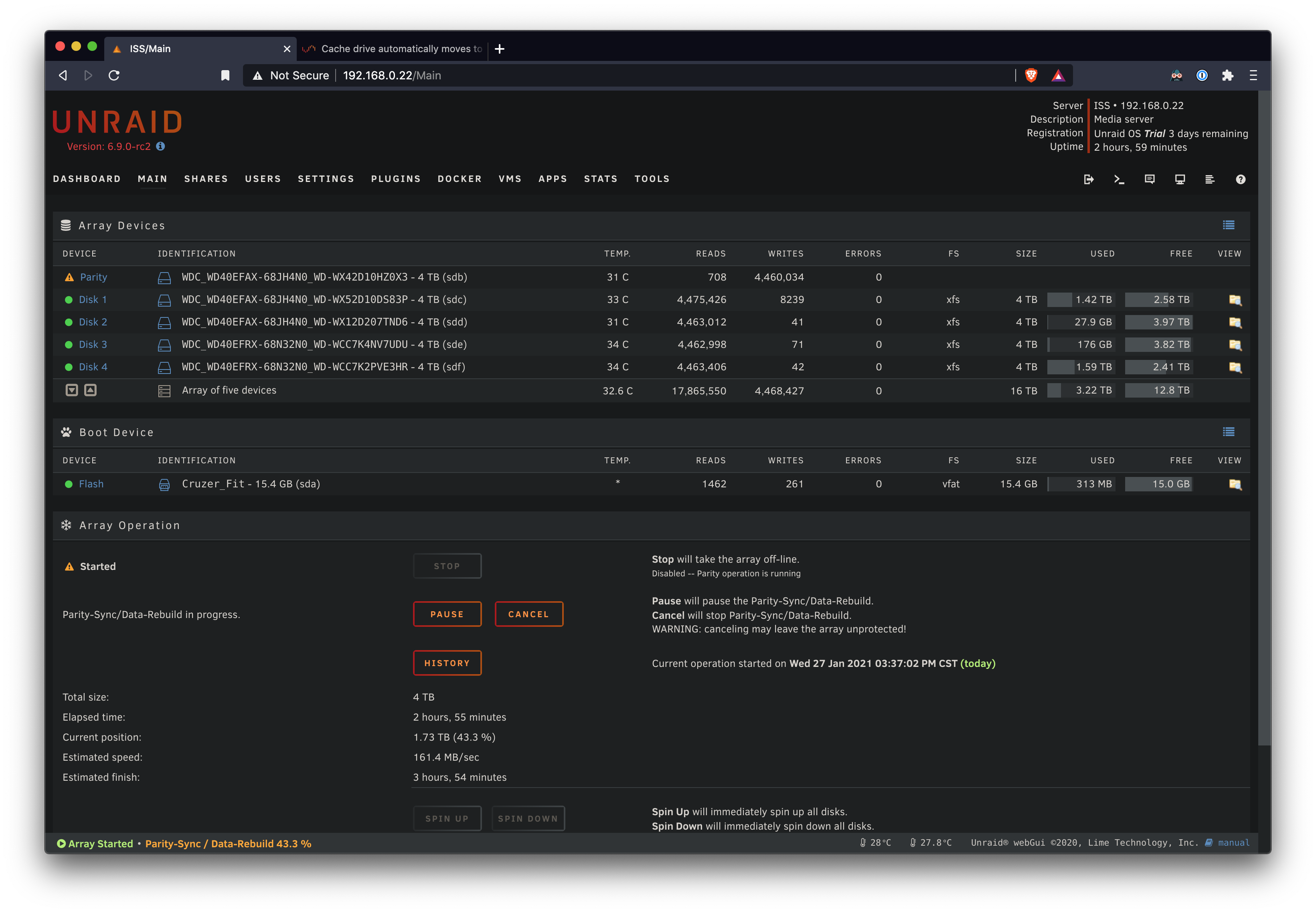

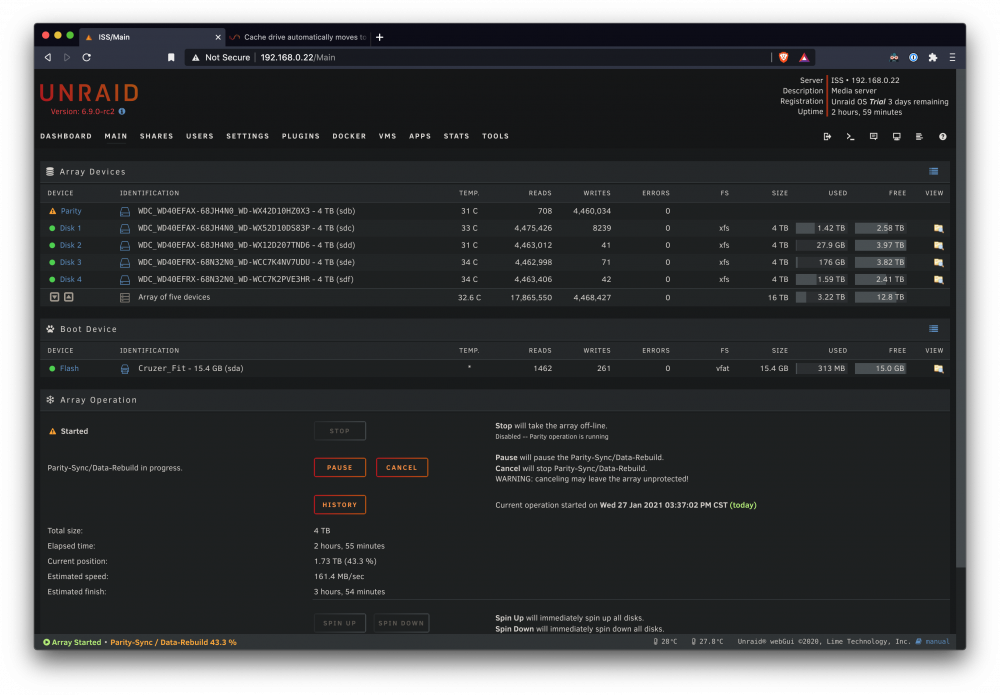

I'm confused. Could you please post a screenshot of the Main tab in the GUI?
we meet again - here you go
10 minutes ago, starwak3 said:
here you go
Confusion averted. When you said...
2 hours ago, starwak3 said:
Parity check / data-rebuild is underway.
I was concerned that things weren't going as planned.
I see it's actually a Parity Sync, which is proper.
