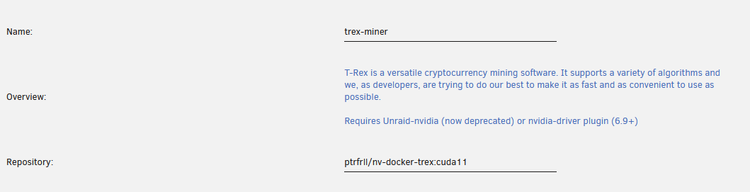

Can you try updating the docker to pull the cuda11 tag like so:
ptrfrll/nv-docker-trex:cuda11
yup all good, now using CUDA 11.10 when pulling the cuda11 tag
Thanks! Tried that and all working now. I take it there is no option to adjust clocks or power anyway?
