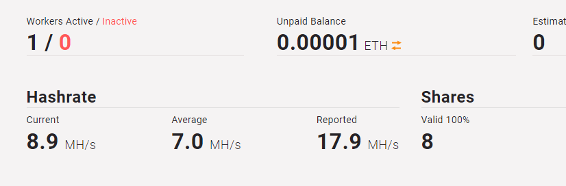

I've had a pay around with my 3070 and got it passed through to a VM where it does indeed hash at 61mh/s with the memory overclocked. In this docker it sits at 51/52mh/s. I have been successful in adjusting the power limit using nvidia-smi as you proposed above. This worked perfectly and halved my power usage. I was also able to set the core GPU clock also using nvidia-smi with no issues. I did have to set persistance mode on.
For the memory however, I can only see a command mentioned as like this:
nvidia-smi -i 0 -ac 2000,1000
But when I do that I get the following error:
Setting applications clocks is not supported for GPU 00000000:06:00.0.
Treating as warning and moving on.
All done.
So it seems adjusting memory clocks is not possible? I googled and also saw that if you have "N/A" in the output for "nvidia-smi -q" in a lot of places, this means that your GPU does not support that feature. I can see N/A against the application clocks part as per below output. Maybe this is why the above error occurs.
 Clocks
        Graphics                          : 1005 MHz
        SM                                : 1005 MHz
        Memory                            : 6800 MHz
        Video                             : 900 MHz
    Applications Clocks
        Graphics                          : N/A
        Memory                            : N/A
    Default Applications Clocks
        Graphics                          : N/A
        Memory                            : N/A
    Max Clocks
        Graphics                          : 2100 MHz
        SM                                : 2100 MHz
        Memory                            : 7001 MHz
        Video                             : 1950 MHz
    Max Customer Boost Clocks
I can see mention of using "nvidia-settings" or xconfig or powermizer to adjust things like memory, but I think this is only possible on more feature rich Linux distros like ubuntu possibly. Have you any other ideas how we can overclock memory somehow? This would be a killer feature to have it set and running inside a docket as you say, since then it is not bound to a VM and is accessible as a shared resource for both mining at its full potential, as well as for plex transcoding duties.

I have just set this up on a p4000 can anyone explain to me why the current and reported hashrates are so different, is this because of dev and pool fees?
I believe current hashrate is based of a 24hr period. More here
