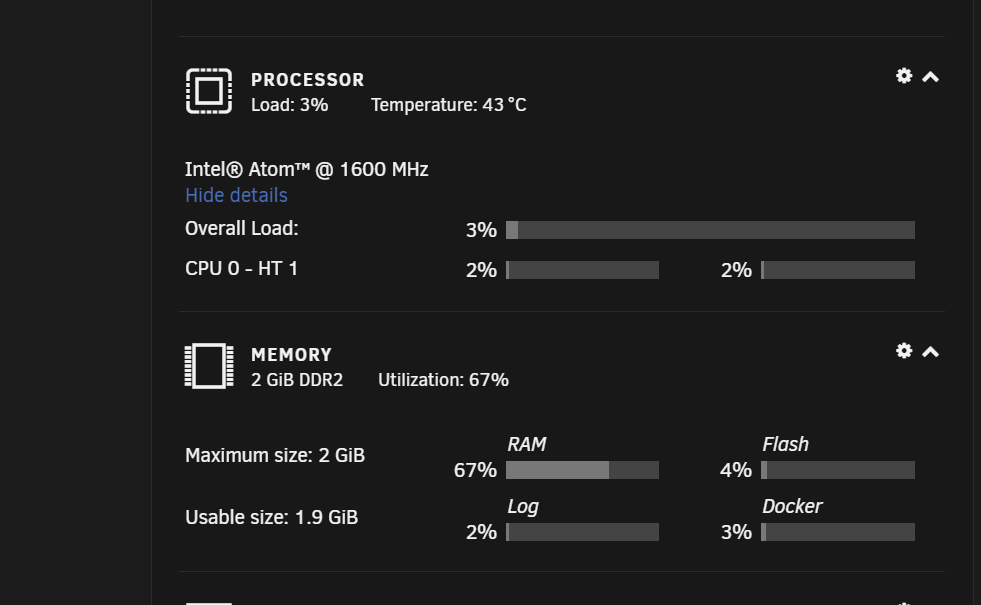

so is the rootfs  saying the 91% is the 2gb of ram. is that what it basiclly saying
would it be also from  running Rsync from the other computers increasing the ram?  and is there a way to see in the tmp folder what is taking up the most of the ram?  i did turn off krusadader went from 66 to  63%  but is there a way to look in the tmp folder whats taking up the ram?  or  what not

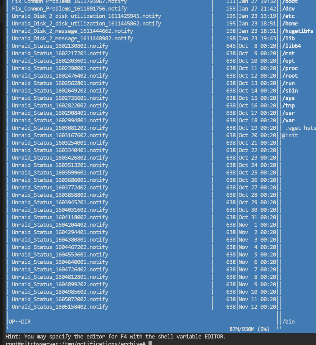

i used the mc  to look in the /tmp
didnt see much  except the notifications  has a lot of notifications but thats about it.. could it be that? i didnt see much in there
in notifications/archive
Edited by comet424
i cant seem to hightlight all the notifications lot more notifications in the tmp   in MC  i thought hold the shift and cursor  doesnt let me

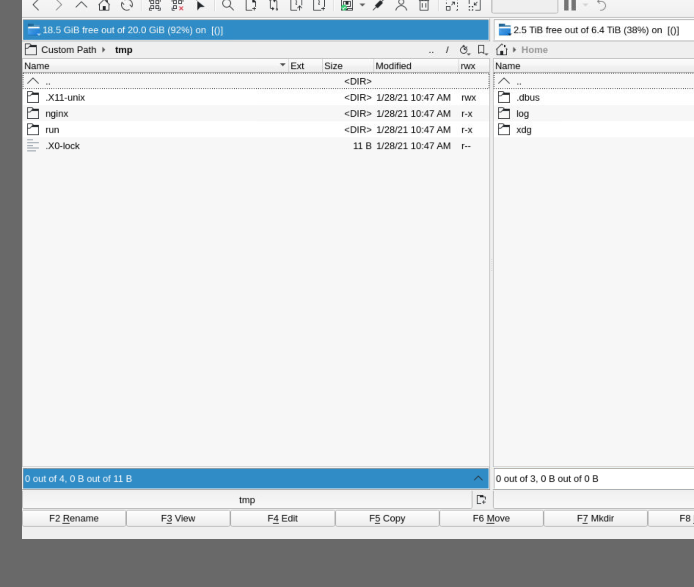

i fired up Krusader and i cant see the same folders
as i was gonna delete in there
Use the Insert key to multiselect
