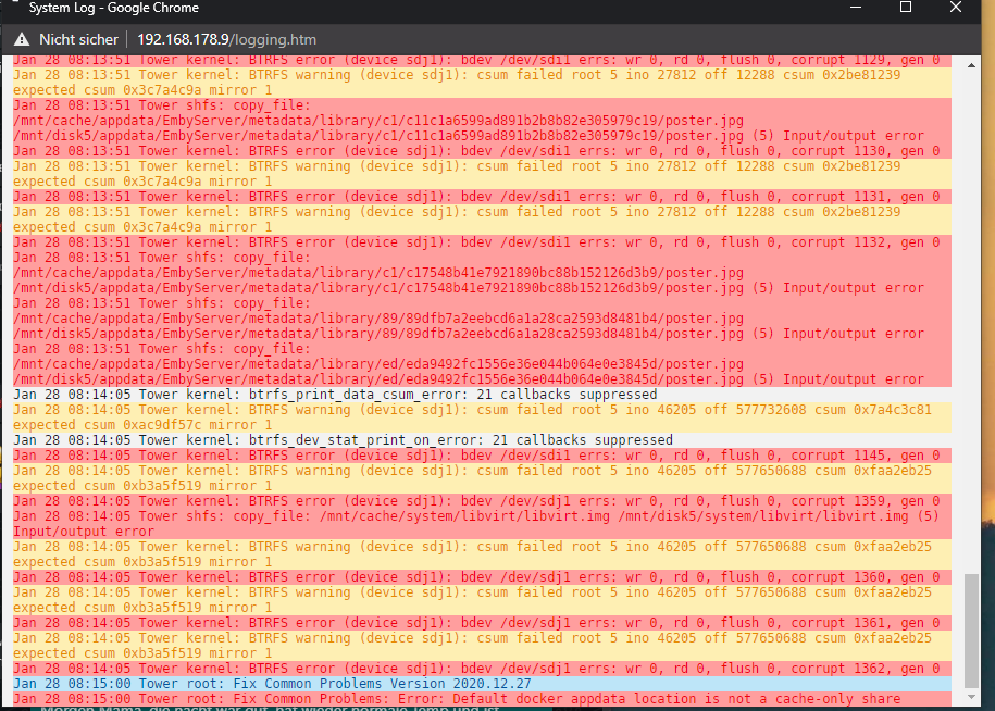

My server consists of an amd ryzen 3200g cpu, asus b450m-a2 mb, 8gb of ram and 1 8TB parity disk and 7 data disks (6x 4tb, 1x 8tb) on xfs filesystem. cache is on 2 1tb samsung ssds with raid0 and btrfs.
i want to free my cache completly cause my newly copied files arent moved to the array.
this is my log screenshot when running mover.
Please help me. if recreating unraid in total is the way i will do so as long as my array data will persist. parity can be recreated without problems. parity check last night went through without sync errors
Those are checksum errors, it means data is getting corrupt, please post the diagnostics: Tools -> Diagnostics

Data corruption and lots of segfaulting suggest a hardware issue, start by running memtest.
Memtest showed that the newly ordered ram stick was faulty from 1728mb.
