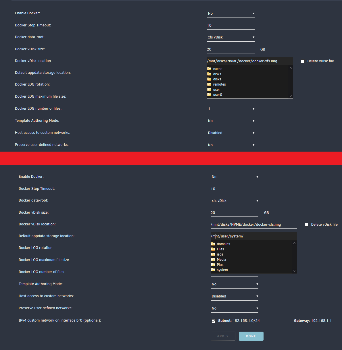

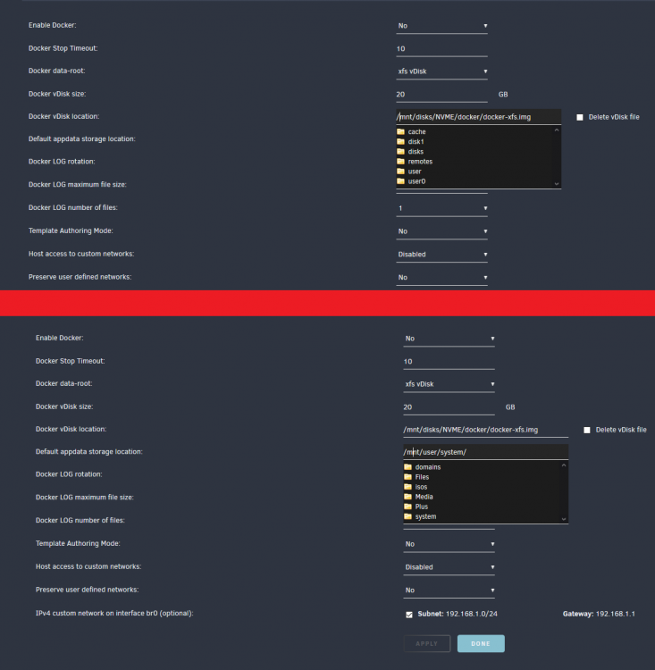

So I had everything working, except I noticed my Cache drive was set to Btrfs so I stopped the array to chagne it to XFS.  After doing so, my docker doesnt seem to find its old appdata share on the unassigned disk anymore.  I can set the docker image file to the unassigned disk but when I click into the path I get the array shares instead for the appdata folder.  Please see screenshot for what I see when I click on the 2 fields.Capture1.thumb.PNG.aab850e03c5d1153191a6725ecba5f8f.PNG
So the same problem is happening for VMs.  I cant select my unassigned device or cache drive.  Whats going on here?

It must be a bug then.  I made sure my csche drive was empty before switching to xfs and formatted it and everything.  That part went off without a hitch.  I guess its the only change I did before I noticed this started happening so I mentioned it.
Typing the name manually does appear to have worked because I have my krusader and other dockers running now.  I basically deleted everything docker related.  Image file, Dockerman templates, etc and restarted from scratch.  The bug is still there, but I can manually type the path.  Looks like the VMs are having the same issue but I have yet to try setting one up, so hoping I can manually type a path there too
