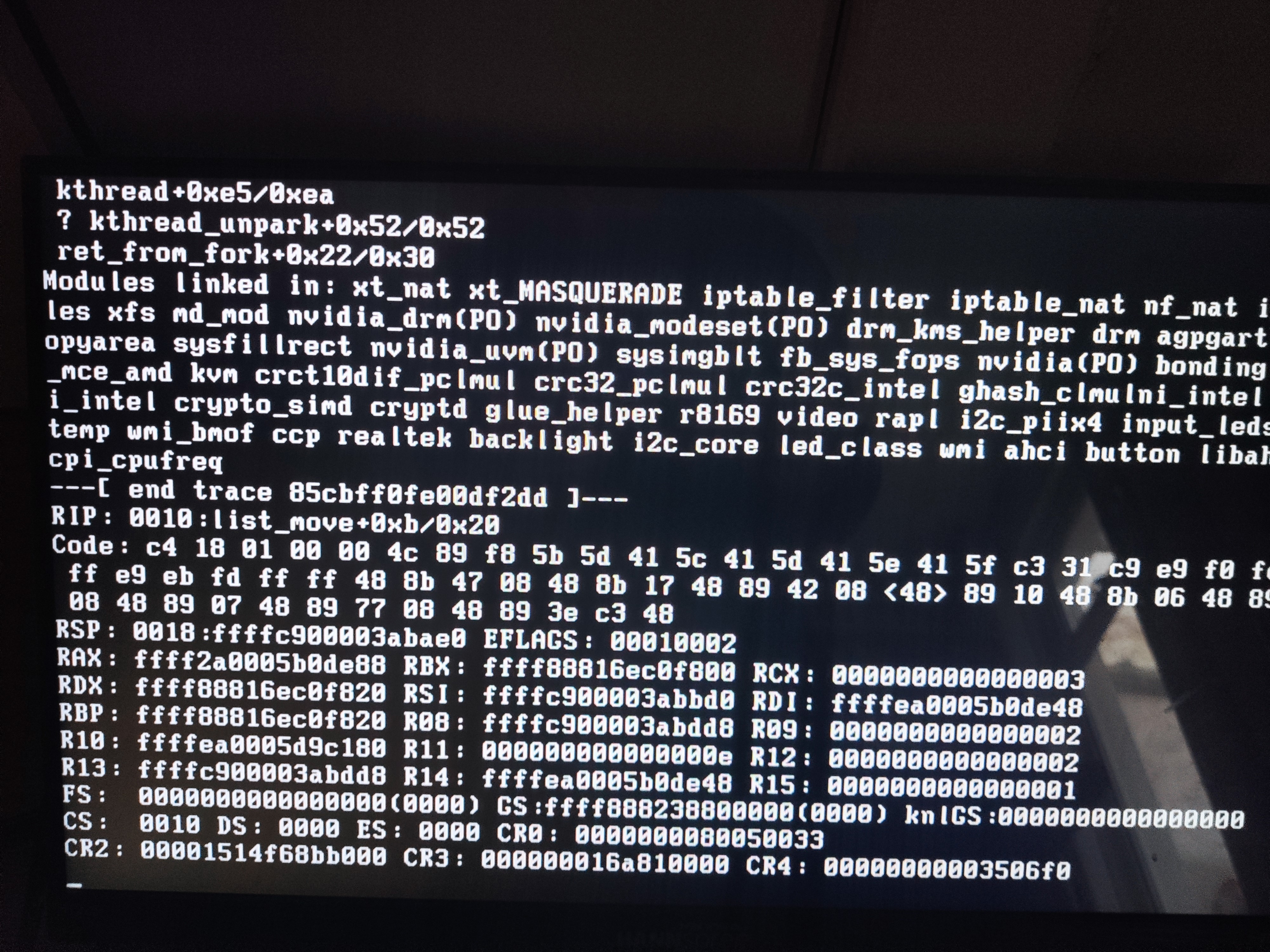

Died again this morning when only Plex was doing its scheduled tasks. Attached is what was on the monitor shortly before it died....I cant make any sense out of it!
Also, new Syslog file from latest crash.
syslog (6)

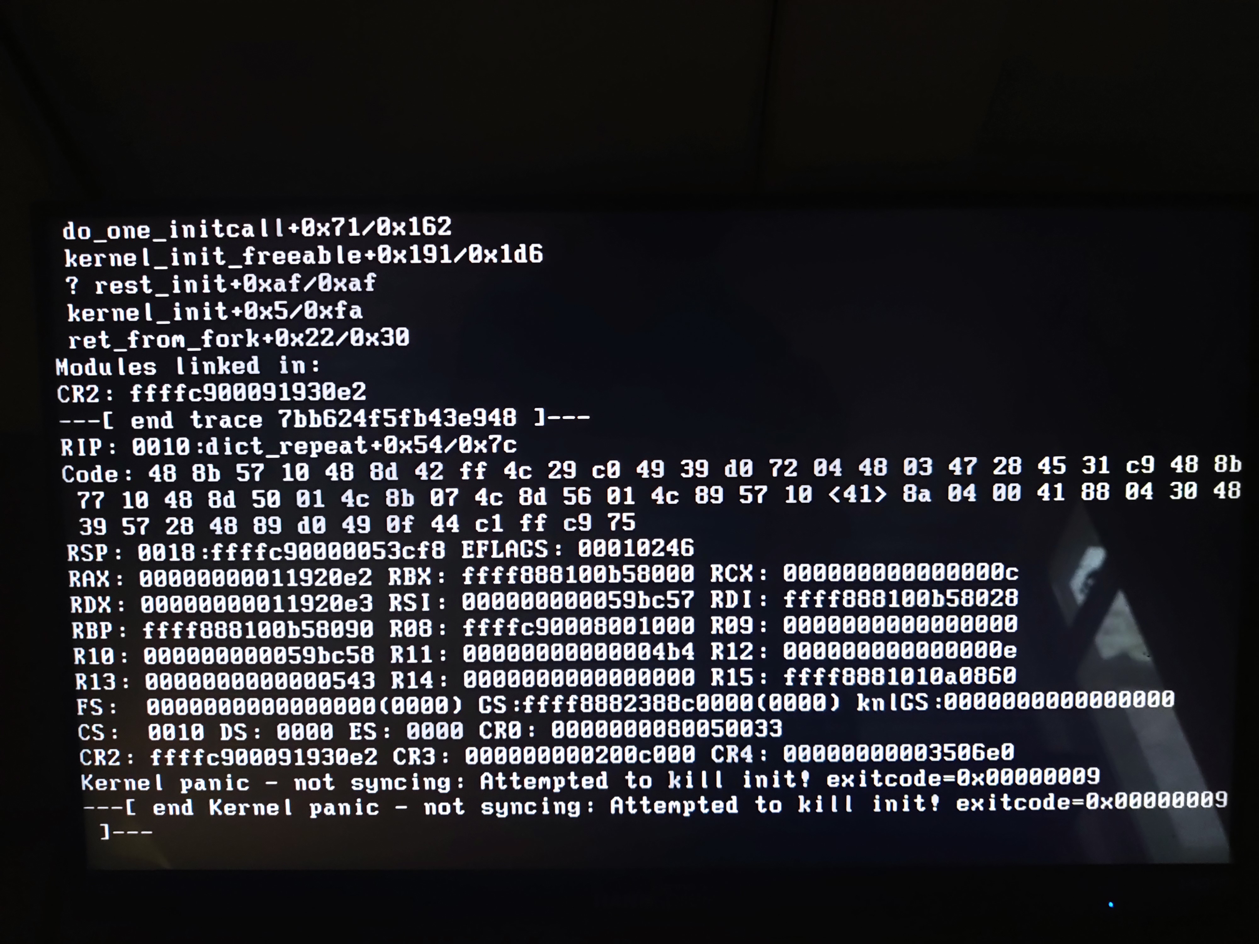

This also came up whenever I was trying to boot after a failure..Not sure if its related.
Just rebooted and it booted into Unraid.
