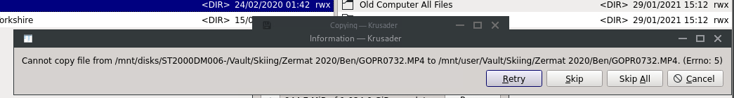

Mounted the drive no issues, when attempting to copy data from the drive to the array, this is the error I get.
My drives were formatted yesterday, and are almost empty, bar 20GB.
Could it be they weren't formatted correctly?
or loosing the drive yesterday, has caused another corruption?

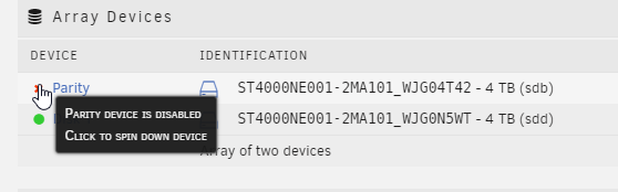

I seem to be writing into the array fine, but parity is not happy. Any ideas?
31 minutes ago, stingray060 said:
how you fix a corruption.
That is exactly what the link you quoted is about.
Diagnostics?

Gotcha, I re-formatted my drive yesterday after it broke, by changing the file type to btrfs then back to xfs.
Didn't do anything to the parity, but when attempted to move files, kicked up a fuss. Only thing I changed was swapped the drive for a brand new one. Which has fixed the issue, 400GB into transferring files now.
Edited by stingray060
Looks like you rebooted before getting those diagnostics so can't see what might have happened to disable parity. You will have to rebuild it of course.
Run an extended SMART test on parity.
It says unable due to disk not spun up.
