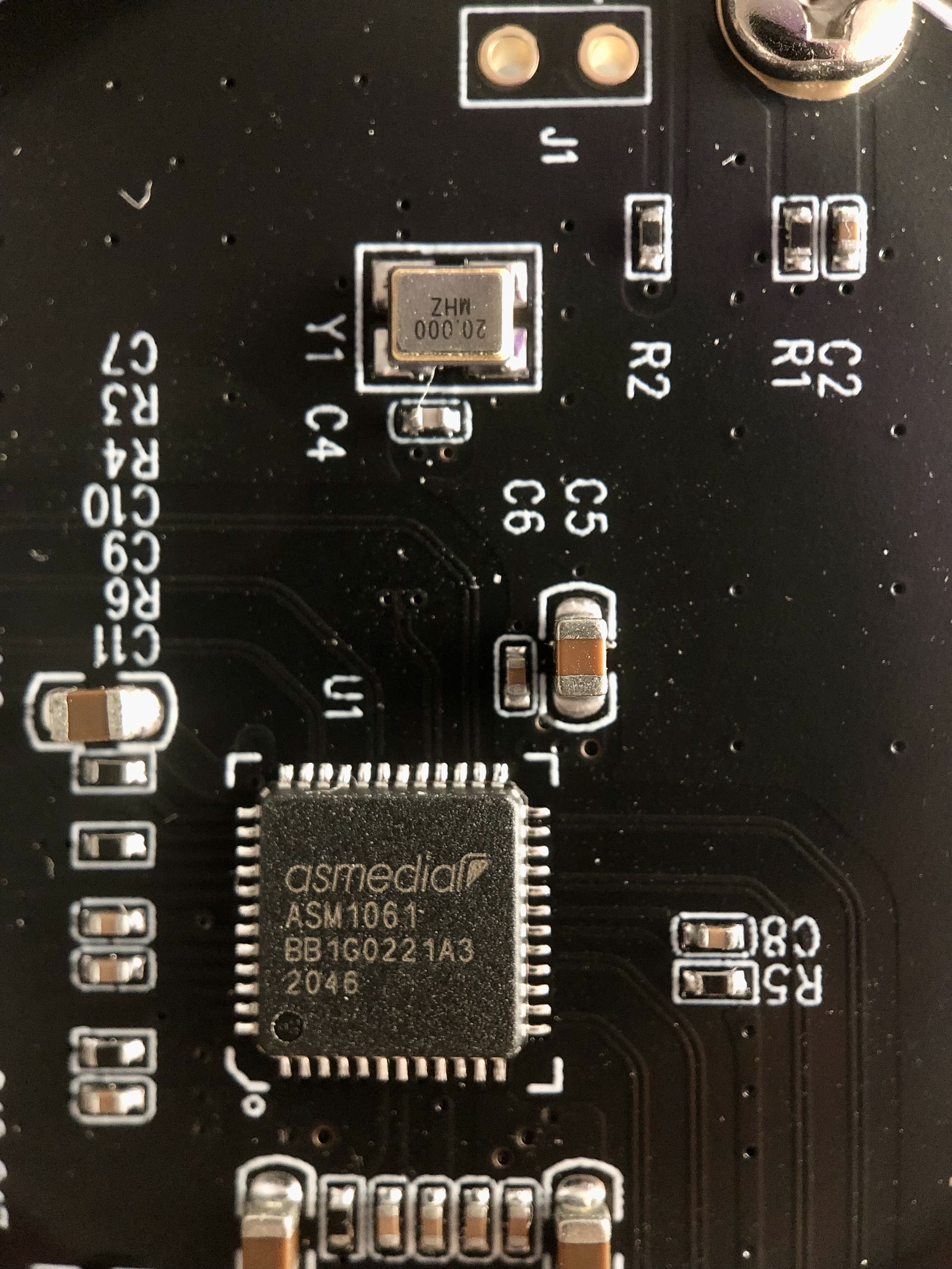

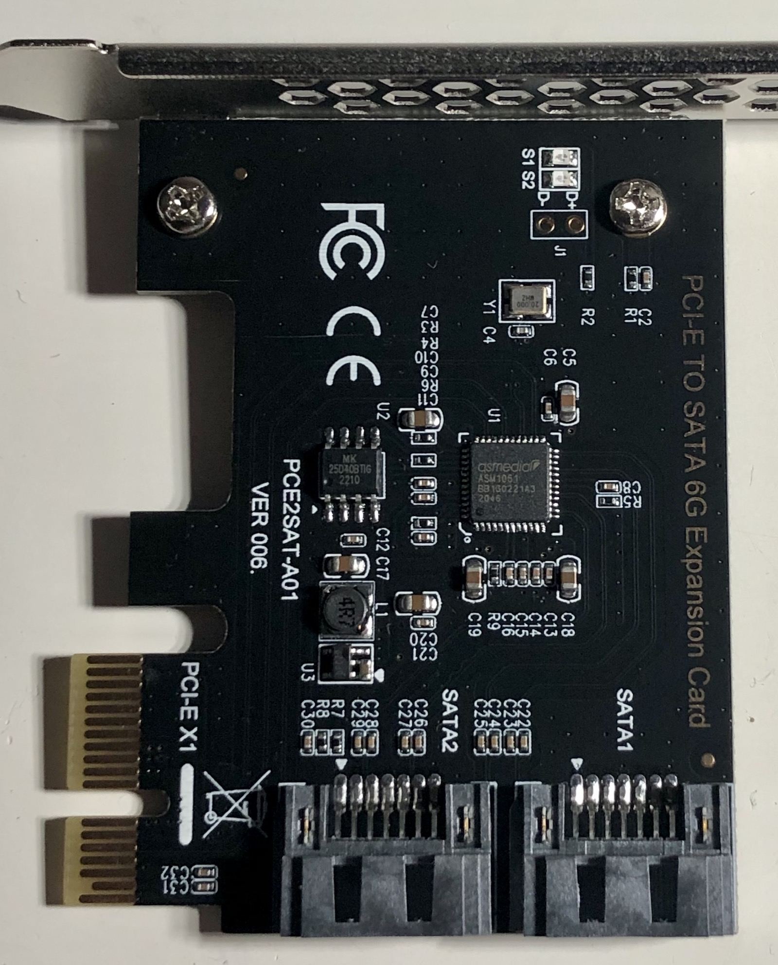

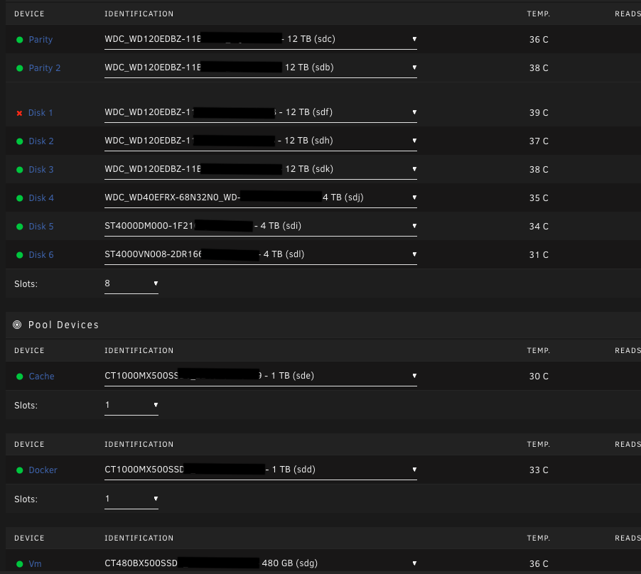

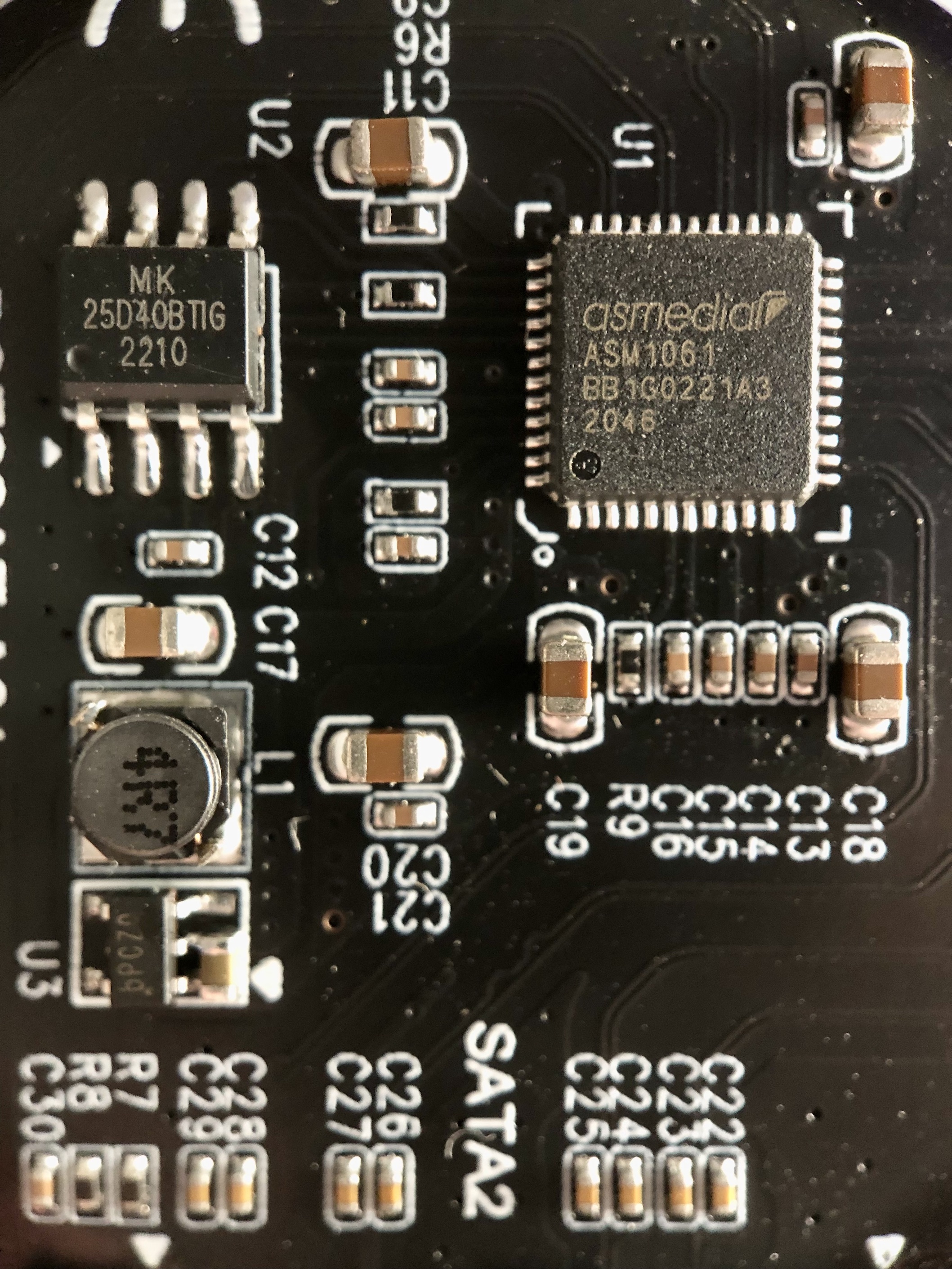

Hello JorgeB,
I bought this card : https://www.amazon.fr/BEYIMEI-contrôleur-dextension-Adaptateur-Ordinateur/dp/B07PRRQ41J/ref=cm_cr_arp_d_product_top?ie=UTF8
It is a ASM1061, which is supposed to work with Unraid.
After plug-in it (with one SSD attached), four drives (connected to the motherboard) went in error state, and one of these (non-pool drives) were "disabled" (following your advice, i ran a filesystem check and it is now rebuilding).
I don't undertand why.
I have 2 CGs (PCIe 3.0 x8 and x4) and one HBA LSI 9200-8i (PCIe 3.0 x2, if i understand well my ASRock X570S PG Riptide motherboard), and two PCIe 1x port are masked (because of CG), so only have one PCI 1x availaible. I thought it was a good option.
Do you think i can try your "4 ports: Asmedia ASM1064 (PCIe 3.0 x1)" (like this one : https://www.amazon.fr/IO-Crest-ASMedia-Non-Raid-Support/dp/B08J2PK1HF), or i will have the same issue ?
Thanks for your time,
K.
That's strange, please start a new thread in the general support forum and attach the diagnostics (before rebooting).
