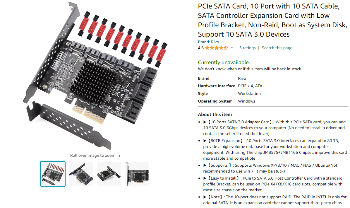

Found this thread from another where I wanted to purchase a 9300 LSI controller to replace this.   Is this considered a bad controller because it has 10 ports?  I got 2 years ago but still using it and don't have problems, but I need better speed.    I don't think this is Marvel Controller Chipset - Jorge, what do you think of this?
No, it's a bad controller because it uses a 5 port controller with a multiplier.
Can you recommend one that has a several ports on it that I can purchase on Amazon.   Like I said, I really was interested in the LSI 9300 and came super close to ordering it but when I started reading how hot it got and you need to mount a fan, etc, I decided against it because of the chance of ruining the motherboard or other heat related issues.  I have good cooling in the system where the CPU is 32 and the drives temps are 34 to 43 but I just don't want to chance it.  If you or anyone can recommend a controller that will give me 8 or more connections (I have 12 total drives including 10 SATA and 2 SSD).
