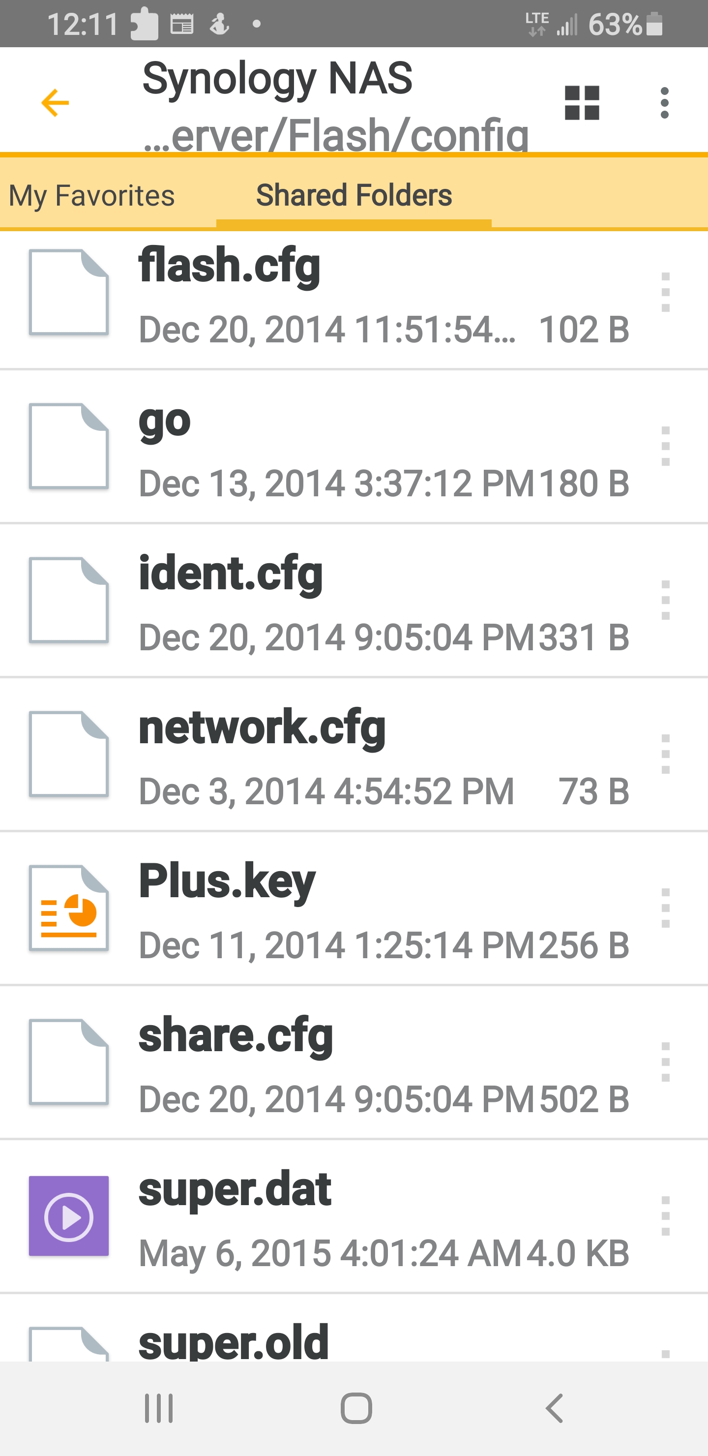

At work, but looked at the copy of my V5 USB that I saved on my Synology NAS and found the Plus Key under config.

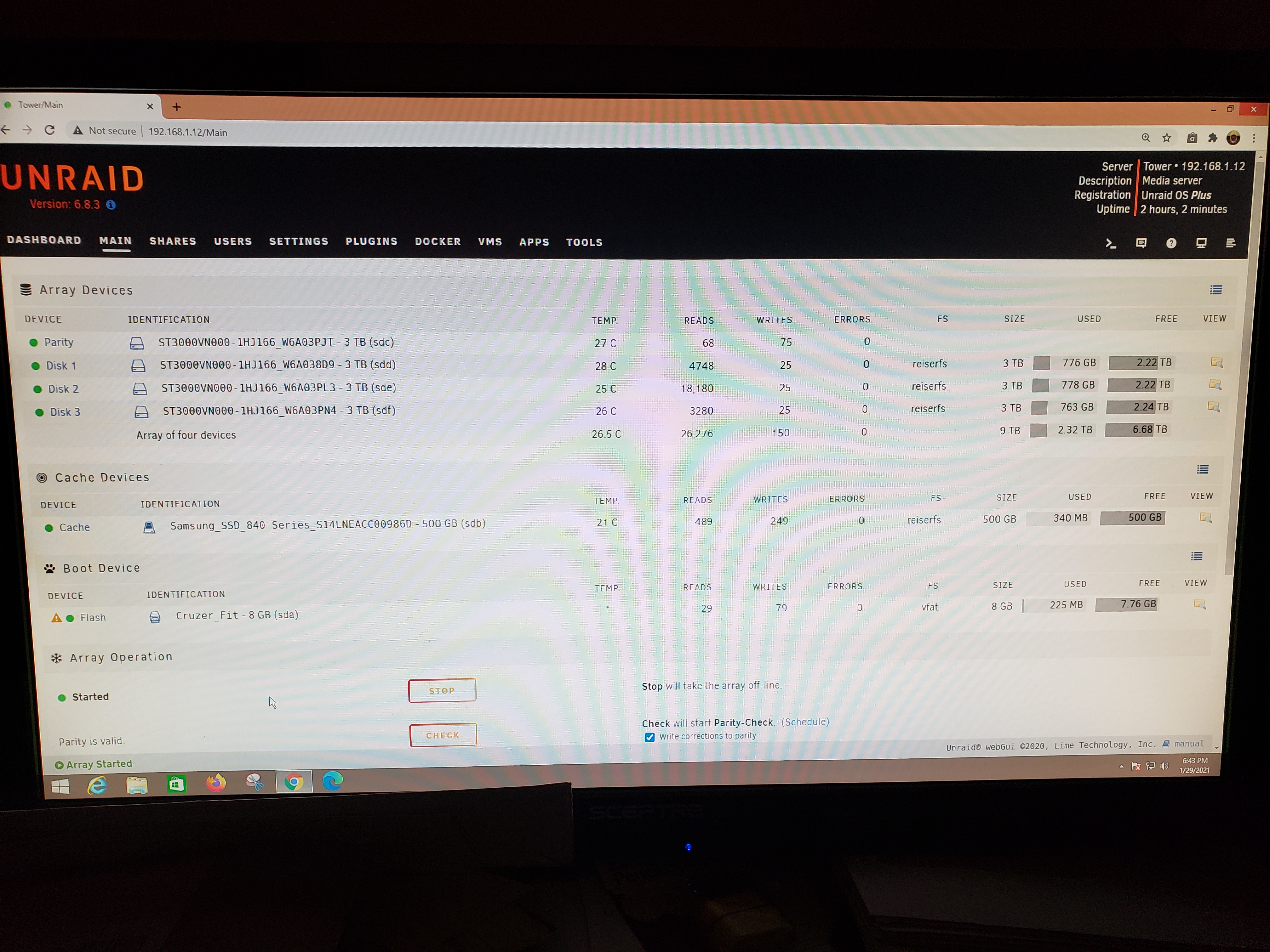

I have one 3T Parity drive, three 3T data drives and a 500gb SSD for cache.

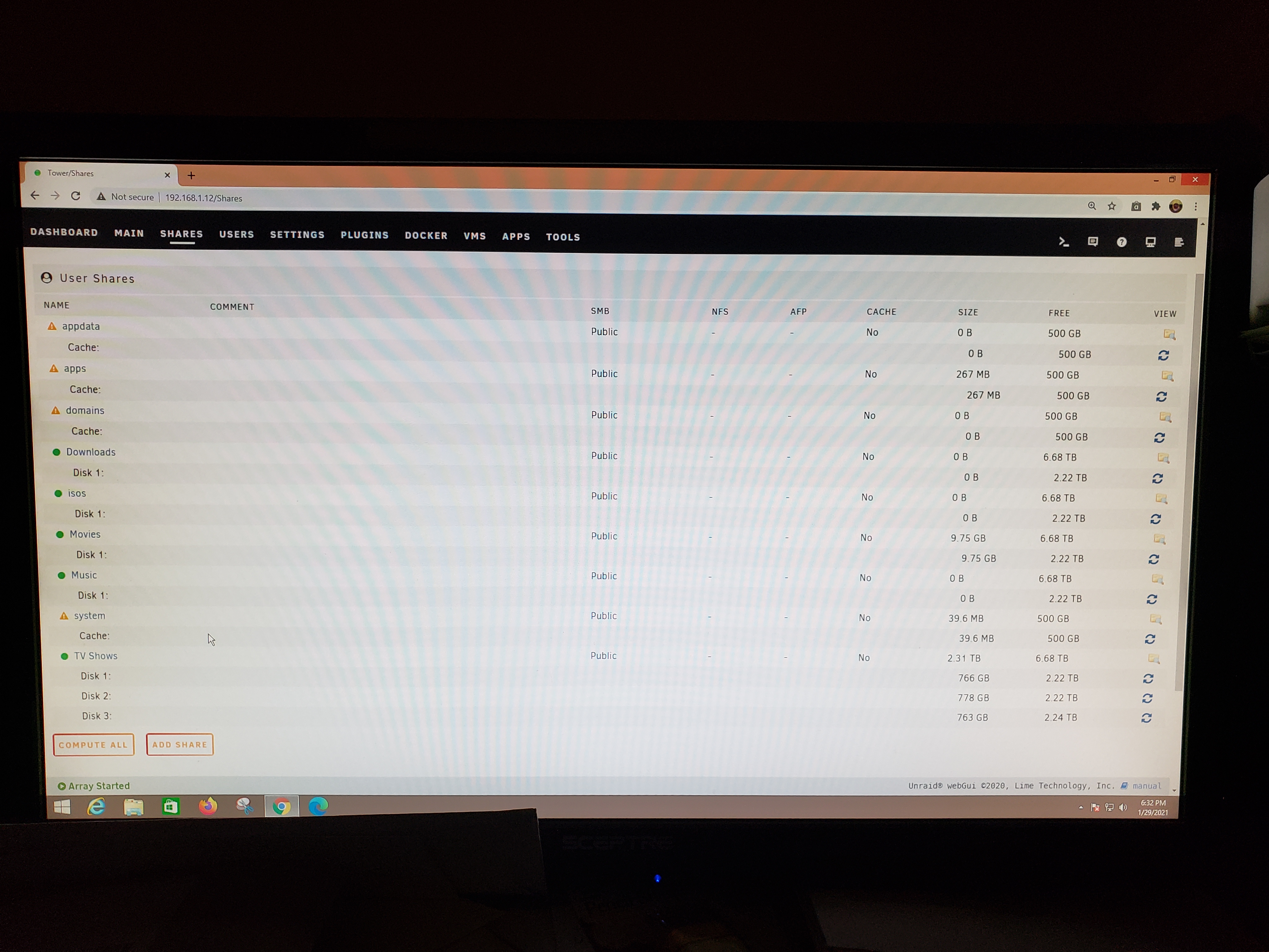

Start by going to the Shares tab and clicking the compute all button, take a screenshot after it finishes calculating and either digest what it's telling you or paste it here and ask.

I clicked on the compute all button, but I'm really not sure what exacty it is telling me.
I want to make sure I have all the shares I need on the cache drive. For the few apps that I'll start out with.
I'll attach a screenshot of the main page and the compute all page under shares.

I recommend dealing with the cache drive first.
Set appdata apps domains and system to cache: yes,
go into settings, docker and vm manager, and disable them both, once that is done you shouldn't have a Docker or VMS tab in the gui,
run mover, check the shares page compute all and make sure none have cache: entries,
then change the format type on the cache drive to xfs if you only ever plan to have a single drive for cache, btrfs if you plan to add a drive for redundancy in the cache pool.
format the cache drive, make sure that's the only drive set to unmountable before checking format
set appdata apps domains and system to cache: prefer
run mover
enable docker and vm manager
