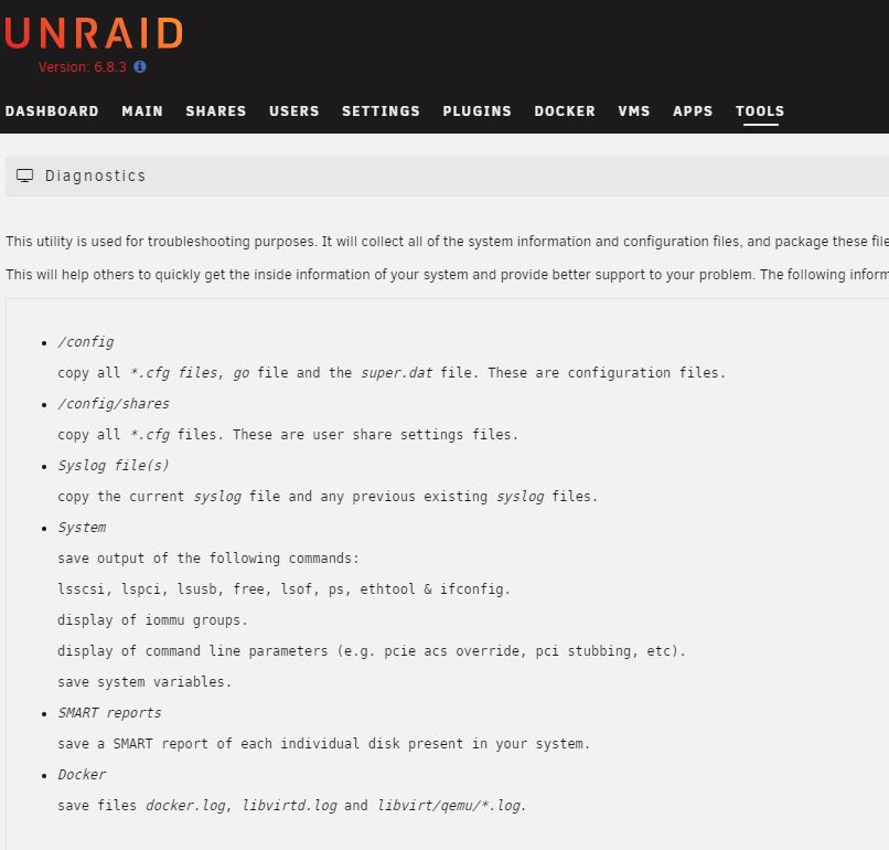

I went to Tools -> Diagnostics.  It goes me the option to download.  Am I doing something wrong?
Under the bit shown in your screenshot there should be a Download button that will give you a zip file that can then be uploaded to the forum.
