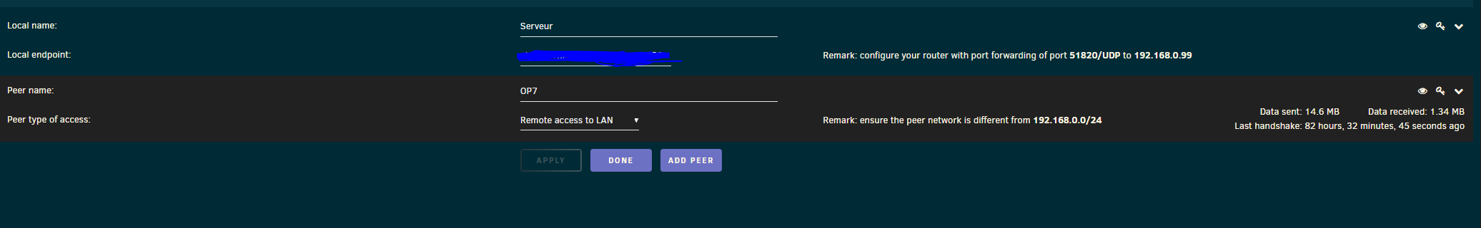

Hello,
Maybe try to enable access to lan like the picture
3 hours ago, rachid596 said:
Hello,
No, that doesn't work.
"Unable to connect to Home Assistant. There was an error loading Home Assistant, please review the connection settings and try again."

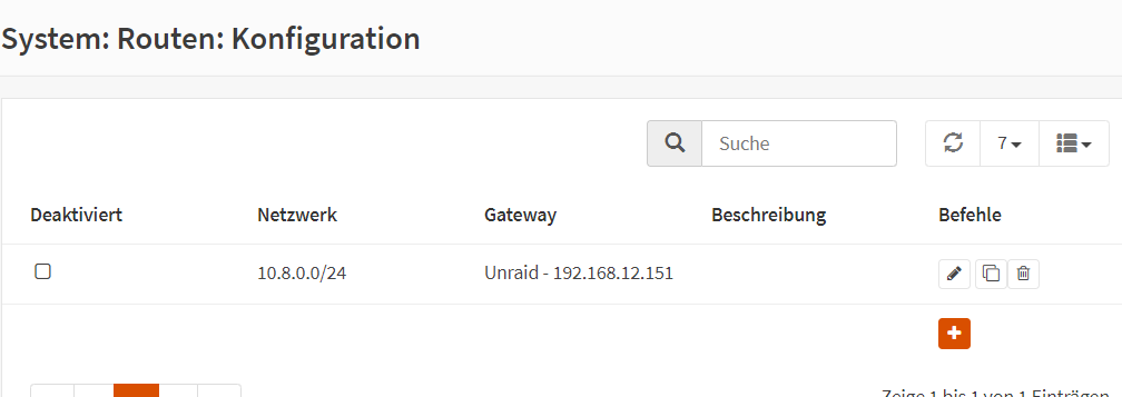

I run into the same problem.
Wireguard VPN tells me:
Remark: configure your router with a static route of 10.8.0.0/24 to 192.168.12.151
What is wrong?
Edited by PlanetDyna

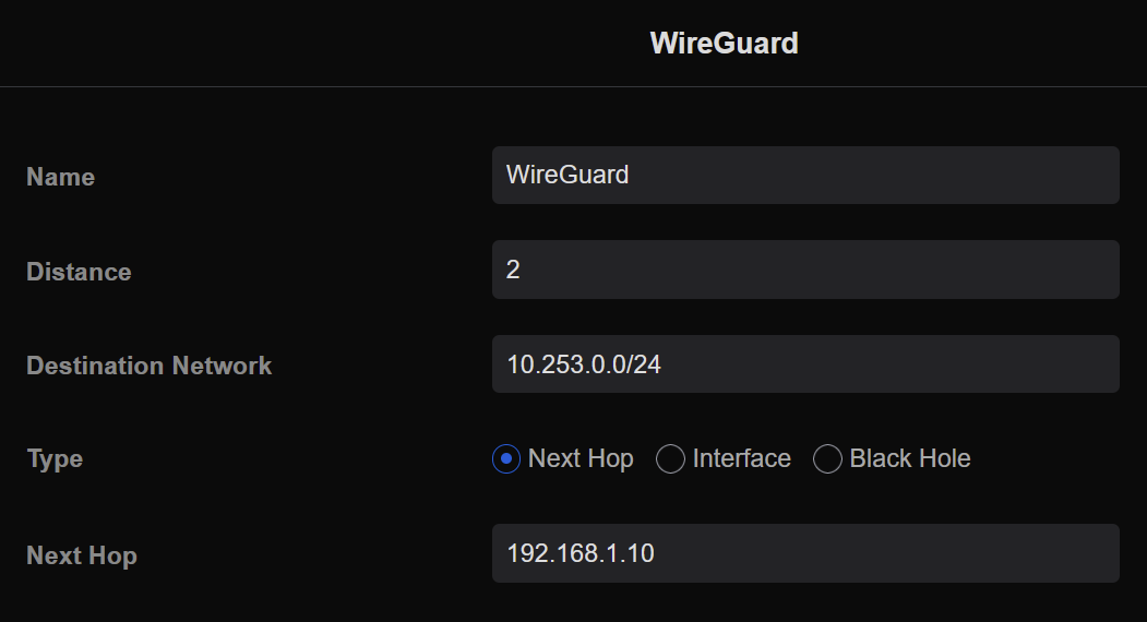

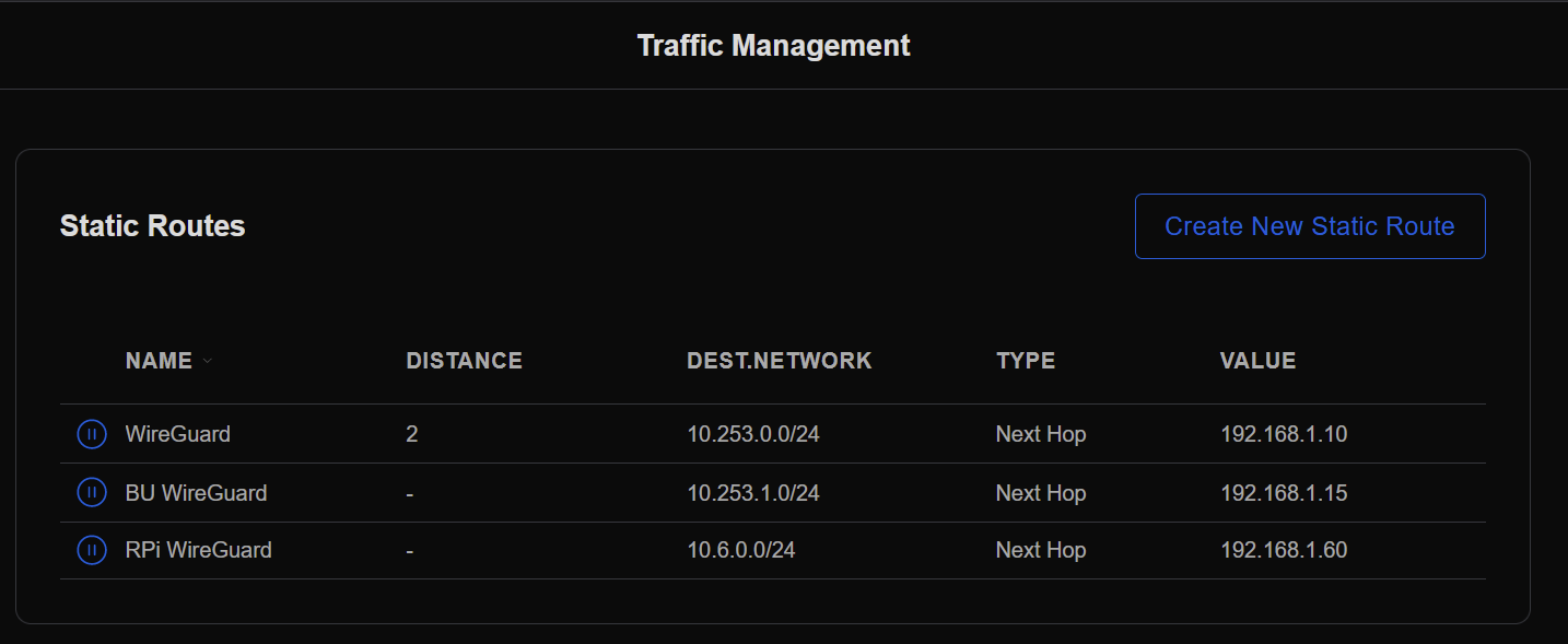

In my router (Ubiquiti USG), the static route configuration looks like this with WireGuard network as Destination Network and unRAID IP address as Next Hop:
In fact, I have three different instances of WireGuard on my LAN each with a static route.
Is the configuration screenshot from your router a static route or is it some other kind of routing rule?
