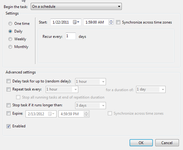

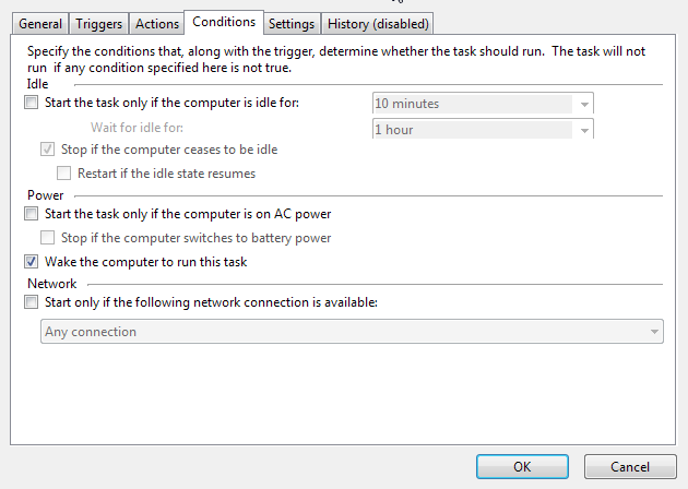

I have set my server to go asleep at a set time but I don't think it's possible to set it to wake up at a specific time. My server wakes up when my media player is switched on or when I run a WOL program from my PC
As I describe in my post #2, I wake up the server from a Win7 PC that send a WOL to the server. The scheduled task wake up the Win7 PC first and then wakeup the server. One minute later, another task start the backup.
On unRaid, I do not know a command that can do a wakeup. Another option is to schedule a wakeup from the BIOS if you have that option in your BIOS.
