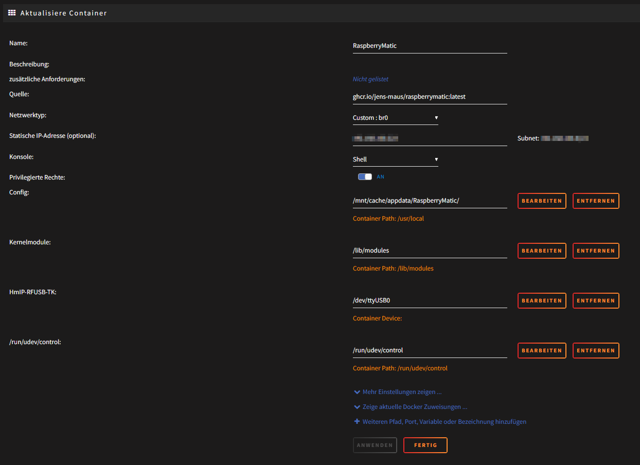

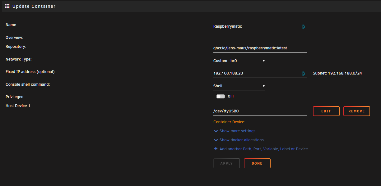

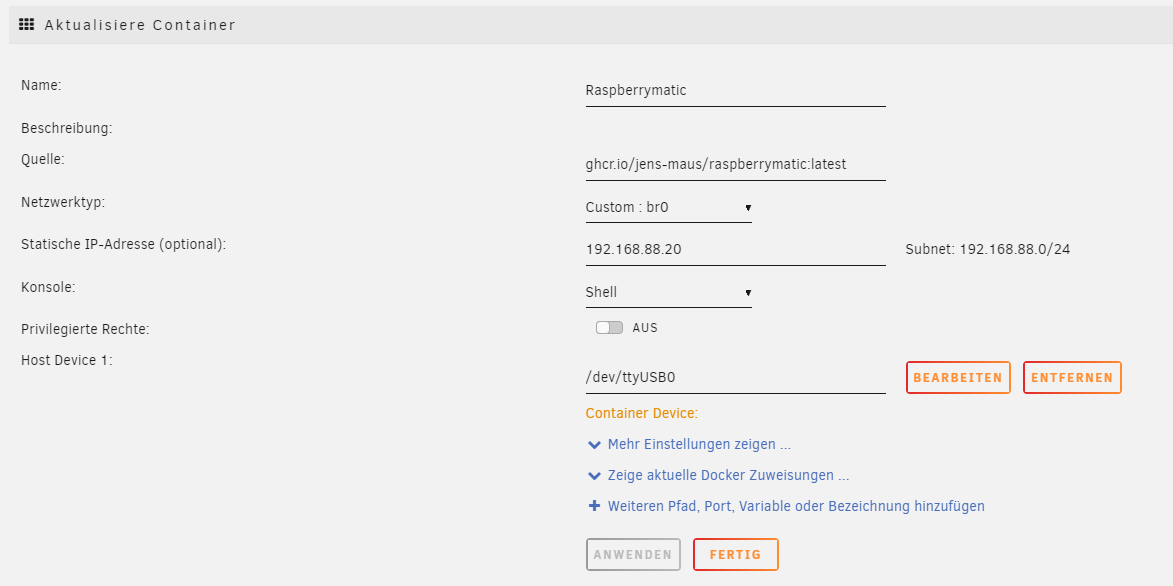

1unraid_user Posted March 27, 2021 Author Share Posted March 27, 2021 I got the docker to run, however I am failing on passing though the RF-USB-2. In case you have problems, check my attached screenshot on my docker-configuration. Regarding the RF-USB-2 it's possible different to a VM the driver actually has to be enabled on host-level. It's weird, as I can pass through the device to the VM without a problem, but it might be the device is not initialised completely on host-level, which then becomes a problem in the docker. In case anyone else is trying this, let me know. Quote Link to comment

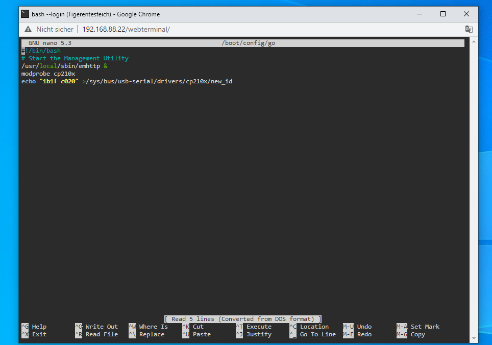

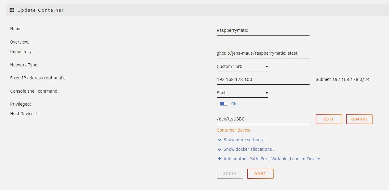

fluppiduppi Posted June 17, 2021 Share Posted June 17, 2021 (edited) RUN RASPBERRYMATIC AS DOCKER + RF-USB STICK I'm using Unraid 6.9.2, no extra driver or software installed. + i use this RF-USB-Stick https://de.elv.com/elv-homematic-ip-arr-bausatz-rf-usb-stick-fuer-alternative-steuerungsplattformen-hmip-rfusb-fuer-smart-home-hausautomation-152306 1. plug in RF-USB stick 2. type in Unraid terminal: modprobe cp210x echo "1b1f c020" >/sys/bus/usb-serial/drivers/cp210x/new_id 3. Container setting. lsusb lsusb -t Edited June 17, 2021 by fluppiduppi Quote Link to comment

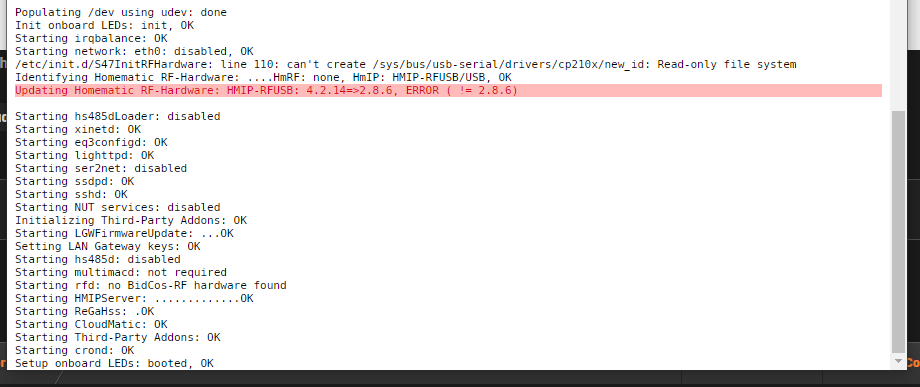

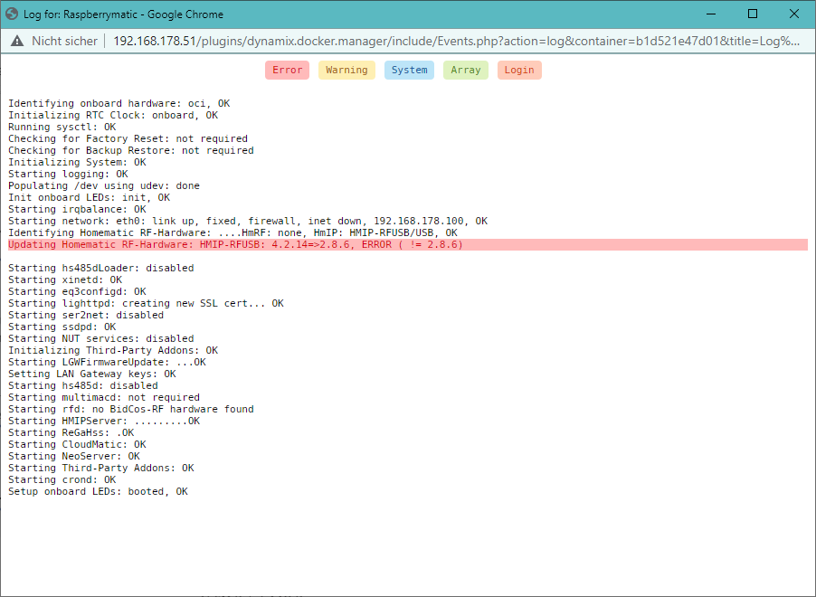

florian84z Posted October 15, 2021 Share Posted October 15, 2021 (edited) On 10/10/2021 at 4:42 PM, fluppiduppi said: Es gibt eine Anleitung wie man mit Docker installiert: https://github.com/jens-maus/RaspberryMatic/wiki/Installation-Docker-OCI Man benötigt eigentlich nur die Quelle : ghcr.io/jens-maus/raspberrymatic:latest Einfach neuen Container hinzufügen, da gibt es keine fertige App im Store. Einstellung siehe mein Post. There is a guide on how to install with Docker: https://github.com/jens-maus/RaspberryMatic/wiki/Installation-Docker-OCI You only need the source: ghcr.io/jens-maus/raspberrymatic:latest Simply add a new container, there is no ready-made app in the store. Settings see my post. Hi! Danke für deinen Hinweis und deine Anleitung. Ich hab den Container soweit eingerichtet, das Webinterface ist auch erreichbar, leider aber habe ich im Log immer einen Fehler und kann auch keine IP Geräte hinzufügen. Hast du eine Idee, was das sein könnte? viele Grüße Florian Edited October 15, 2021 by florian84z Quote Link to comment
fluppiduppi Posted October 16, 2021 Share Posted October 16, 2021 (edited) Hi, den Fehler habe ich auch im Protokoll stehen. Das ist nur ein Firmware Check, glaub ich, nicht so wichtig. Bei dir fehlt aber die Zeile mit dem cp210x Treiber. Hast du die Befehle im unraid Terminal ausgefüht? modprobe cp210x echo "1b1f c020" >/sys/bus/usb-serial/drivers/cp210x/new_id Danach den Docker Container neustarten. Tipp: Im Terminal eingeben, dass beim Neustart des Systems der Treiber automatisch geladen wird: nano /boot/config/go Die Datei dann mit den beiden Befehlen editieren: modprobe cp210x echo "1b1f c020" >/sys/bus/usb-serial/drivers/cp210x/new_id Edited October 16, 2021 by fluppiduppi Quote Link to comment

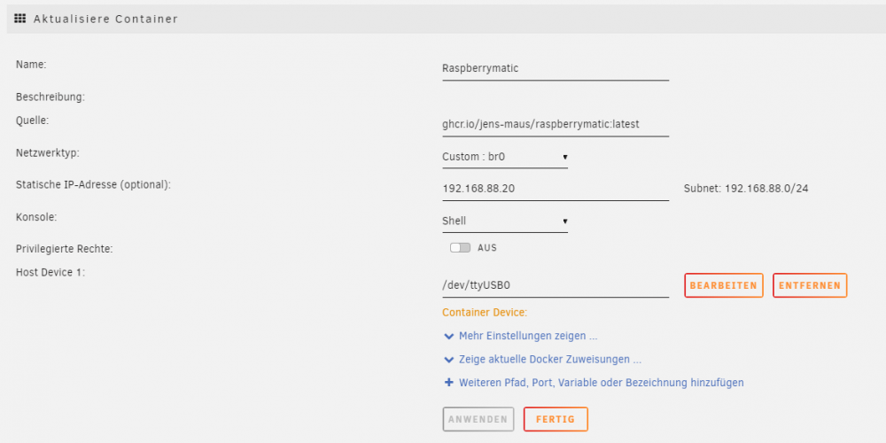

juleztb Posted March 2, 2022 Share Posted March 2, 2022 Hi! I installed the Docker as @fluppiduppi wrote. Everything worked fine and I added one of my water alarm sensors, which also worked fine. Even added it in Homeassistant, running in a VM on Unraid. Then just moments ago I ran an update of the raspberrymatic docker container and it seems like all my settings were wiped. When I tried to log into my raspberrymatic the complete setup process started from zero and everything was gone. At this point I'm quite happy I didn't add all the rest of my Homematic IP devices yet. That would have been a desaster. Yet I don't know how to fix this. I haven't had this problem with any of my other docker containers. All of them always kept their settings when restarting or updating them. Can anyone help me out? This was my configuration: Thanks a lot in advance! PS.: Answering in german is perfectly fine, too - didn't know if there's a convetion in place here. - Antwort auf Deutsch passt auch wunderbar - wusste nicht, ob es hier im Forum eine Konvention gibt. Quote Link to comment
trurl Posted March 2, 2022 Share Posted March 2, 2022 6 minutes ago, juleztb said: all my settings were wiped I don't use this but with most dockers on Unraid you have to map those settings to a host path. That is what appdata is all about. 1 Quote Link to comment
JonathanM Posted March 2, 2022 Share Posted March 2, 2022 13 minutes ago, juleztb said: all my settings were wiped. Like trurl said, it doesn't look like you told it where to save the settings, so it saved them in the container which is erased and recreated on update. I don't know if this works, I don't use it either, but from an image above in this thread. 1 Quote Link to comment
juleztb Posted March 5, 2022 Share Posted March 5, 2022 Thank you @JonathanM and @trurl. That totally fixed it! Quote Link to comment

Patty92 Posted May 14, 2022 Share Posted May 14, 2022 (edited) On 5/13/2022 at 12:04 PM, warp760 said: Hallo zusammen, raspberrymatic an sich läuft im Container. Allerdings bekomme ich keine Verbindung zur HB-RF-ETH Hat das schonmal jemand geschafft? Hey, also bei mir ist es seit dem vorletzten Update glaube, das ich wie vorgegeben "privilegierte Rechte" auf Ja stellen muss, sonst erkennt er bei mir das Funkmodul nicht. Edited May 14, 2022 by Patty92 Quote Link to comment

warp760 Posted May 15, 2022 Share Posted May 15, 2022 13 hours ago, Patty92 said: Hey, also bei mir ist es seit dem vorletzten Update glaube, das ich wie vorgegeben "privilegierte Rechte" auf Ja stellen muss Und hast du irgendwelche Treiber direkt auf m Host nachgeladen oder gings bei dir so? Hast du auch die ETH Platine oder die USB Variante? Quote Link to comment
Patty92 Posted May 15, 2022 Share Posted May 15, 2022 Ich habe derzeit von der Telekom "HmIP-RFUSB-TK". Zusätzlich wie oben beschrieben, folgende Zeilen in der "go"-Datei: nano /boot/config/go modprobe cp210x echo "1b1f c020" >/sys/bus/usb-serial/drivers/cp210x/new_id Quote Link to comment
