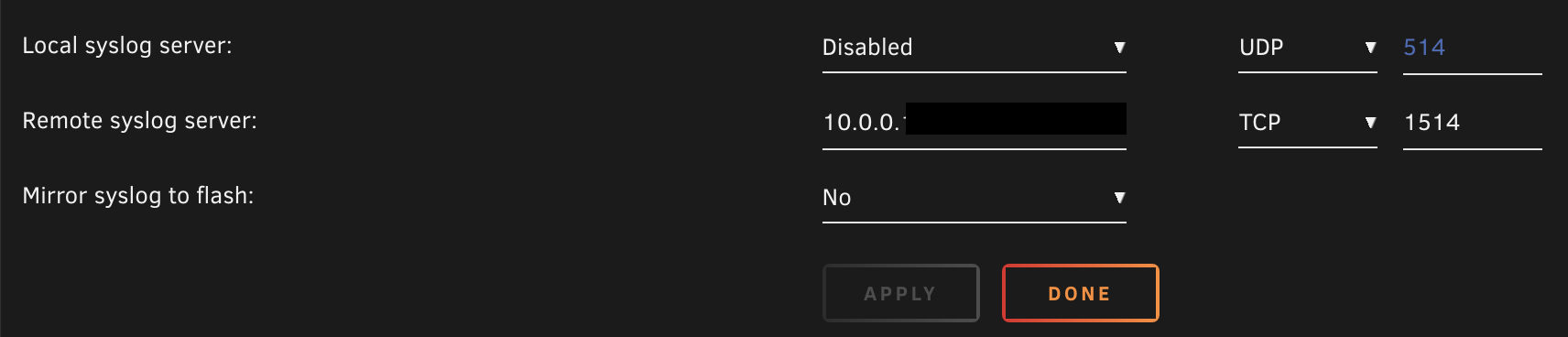

I have promtail-loki-grafana docker stack setup. I tried promtail both on the bridge network and on custom:br0 with its own IP address.
I don't get any messages from my unraid server. I do get messages from another server on my network, so the stack is working.
2047568282_ScreenShot2021-01-30at11_03_53.thumb.png.4882237e42b2d0df2b4f0cbe4fa55ebf.png
Is this related to the docker networks? Some flaw in the syslog implementation. I tried deleting the rsyslog config files off of boot and rebuilding them. No luck there either.

I am running 6.9.0rc2
OK, I deleted the rsyslog config files and rebooted.
Added back in my syslog server, confirmed the entry on rsyslog.conf...
Still nothing.
