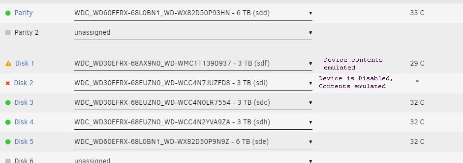

I am expanding the array .   added a 6 TB drive and moved the data from drive 2  (3 TB)  to drive 5 ( 6 TB)  pulled out drive 2,  then plugged it back in.    upon starting Unraid,  it said it needed to rebuild the array which I let it do.   It was uneeded since the drive was emply,  but I let it go anyway.     It completed,  everything looked good.  So I removed drive 1 (3 TB) and replaced it with a 4 TB drive.   Then I got the 2 disks having problems,   Both disk 1 and disk 2.      So I do not know what to do to fix this problem.     2  disks that are not working .    When I started the array   the rebuild started,    but how to rebuild with 2 bad disks both emulated ????   so I stopped the array and now I need a soluton.
I am concerned about data loss.    Disk 1 has  2.5 TB of data.    I am thinking of using an Ubuntu  PC to read and copy the data to a different disk  as a backup.   Since  windows can't read an XFS disk.
enclosed are some pictures of my array.    Please help.

Diags are after rebooting so we can't see what happened, but disk2 appears to be having issues, you should run an extended SMART test, if OK do a new config with it and old disk1 (assuming still available) and re-sync parity, if not OK do a new config without disk2 (or suing a new disk), since it has no data.
