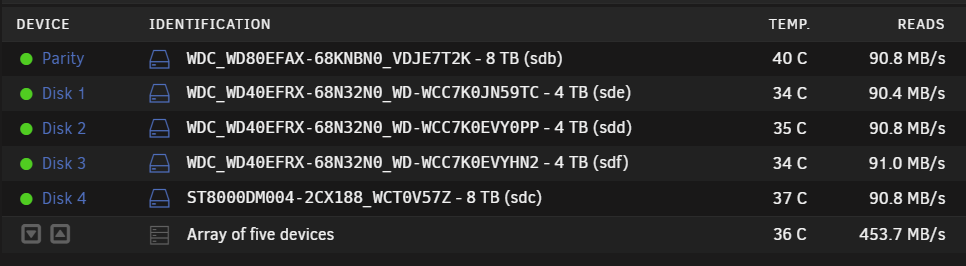

Anyway when the parity check is running it starts out like the first image here where all disks are being checked:

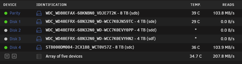

Then it changes to the following behaviour for the last 40% or so where only the 8TB disk is being checked:
I'm sure this is normal, but why?

Because 60% progress ( 60% of 8TB ) already over 4TB, so disk 1,2,3 wouldn't involved anymore.
It took me a while to wrap my head around that but I think I get it.  What I think you're saying is:
  • All disks are involved in parity calculations for the first 4TB
  • Only the parity drive and 8TB drive are involved in parity calculations for the last 4TB.
Does that therefore mean that for the last 4TB of the 8TB drive, it's not technically parity but rather a bit mirror?
And that if I added another 8TB drive to my array it would switch from a bit mirror to actual parity?
Correct
No, it will be parity of last 4TB of disk4, if you add a 8TB disk5, then first 4TB was parity of disk 1-5 and last 4TB was disk 4,5.
OK, yeah I think I'm just lacking in caffeine this morning.  It's no different in functionality to if I had a two drive array (one parity, one data).  It's still "parity" even though it might be conceptually similar to RAID1 (in that only two disks are taking part in the resiliency for this particular data).
I don't think I'd ever recommend that anyone visualised it that way.  It's just helped me wrap my head around what I saw.
