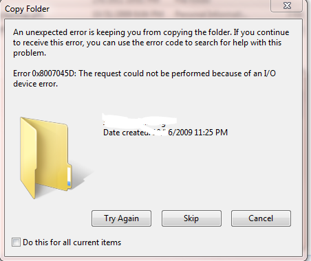

Here's some more details. (Now I'm in v5)
V5 symptoms are the same but actually display an error on the screen when it happens.
I get the attached error in Windows First....
Then I see this come up in the console
REISERFS error (device md1): reiserfs-2025 reiserfs_cache_bitmap_metadata: bitmap block 50659328 is corrupted: first bit must be 1.
