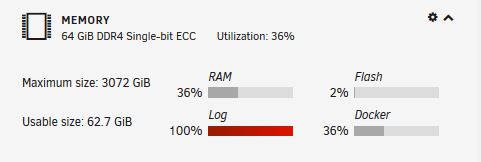

Realized that my memory was slowly creeping towards beeing 100% full. How can I identify the problem?
In unRAID/Syslog I see:
Fatal error: Allowed memory size of 134217728 bytes exhausted (tried to allocate 33554440 bytes) in /usr/local/emhttp/plugins/dynamix/include/Syslog.php on line 20
Opening the log I see this repeating entry, but is that the log?
