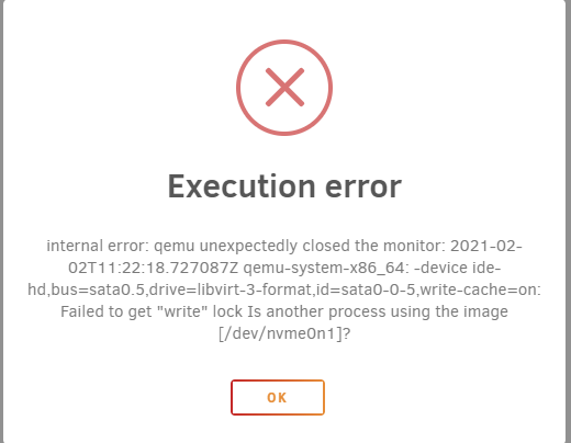

Okay, so I have finally been able to access the nvme drive via the network and copied over the vdisk image, but now I am stuck with pointing the Primary vdisk location to the nvme drive - I have now input: /dev/nvme0n1/vdisk1.img, which is freezing up. When just inputting /dev/nvme0n1, it gives me an error... Any thoughts on what I can do?image.png.4afcd5f026d66a5b68607be006b645ba.png
Earlier you said you wanted to pass the entire nvme drive through, but the path ends in vdisk1.img which suggests you are trying to use a vdisk image file on the nvme :(  Which is it?

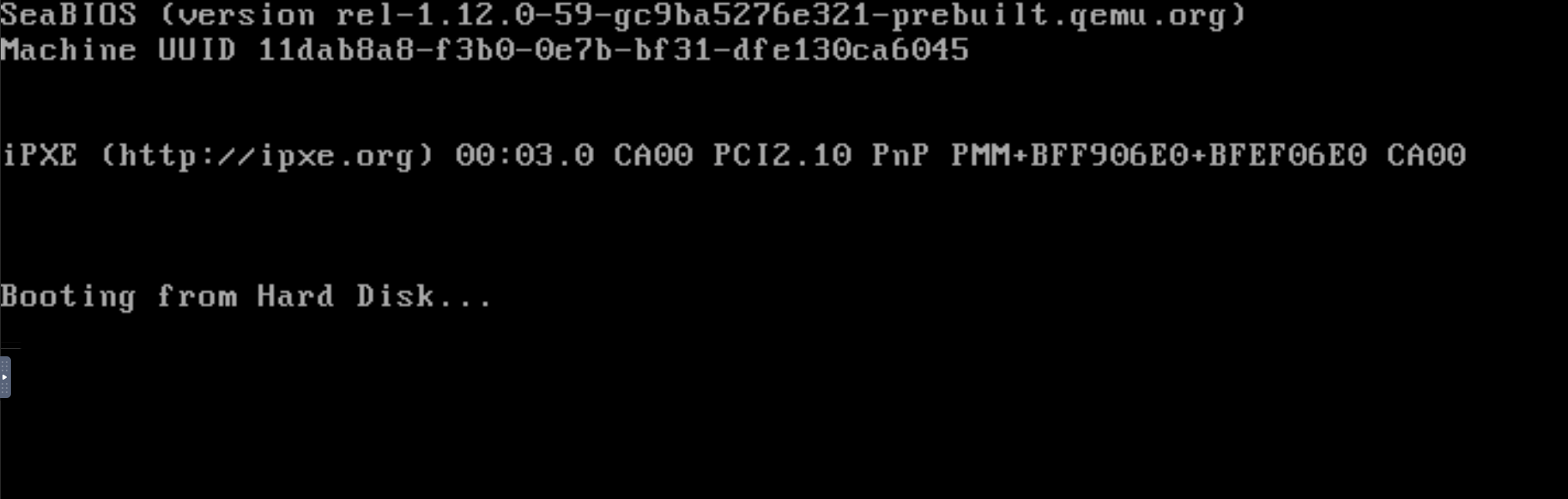

When I do this, I can see in VNC Remote that it is trying to boot from the HDD, not the Nvme anymore :image.thumb.png.11d62f990a63ee7db527a4599d22f3fa.png
When I try to edit the VM, I see that Primary vdisk location is no longer set to "none", but it set to one of the HDD's. As the NVMe is passed through, I can't see it anywhere.

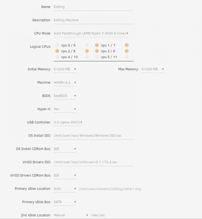

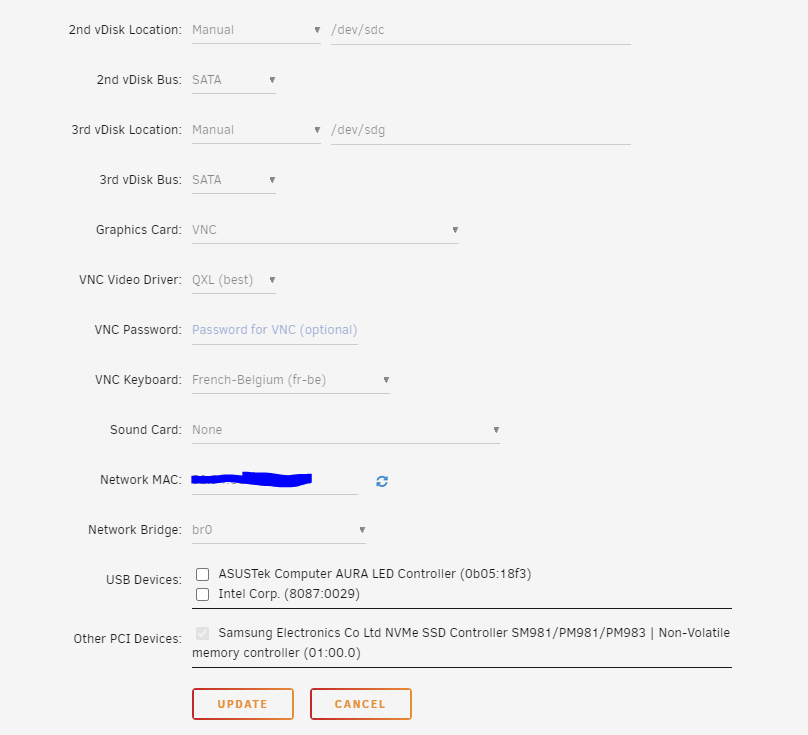

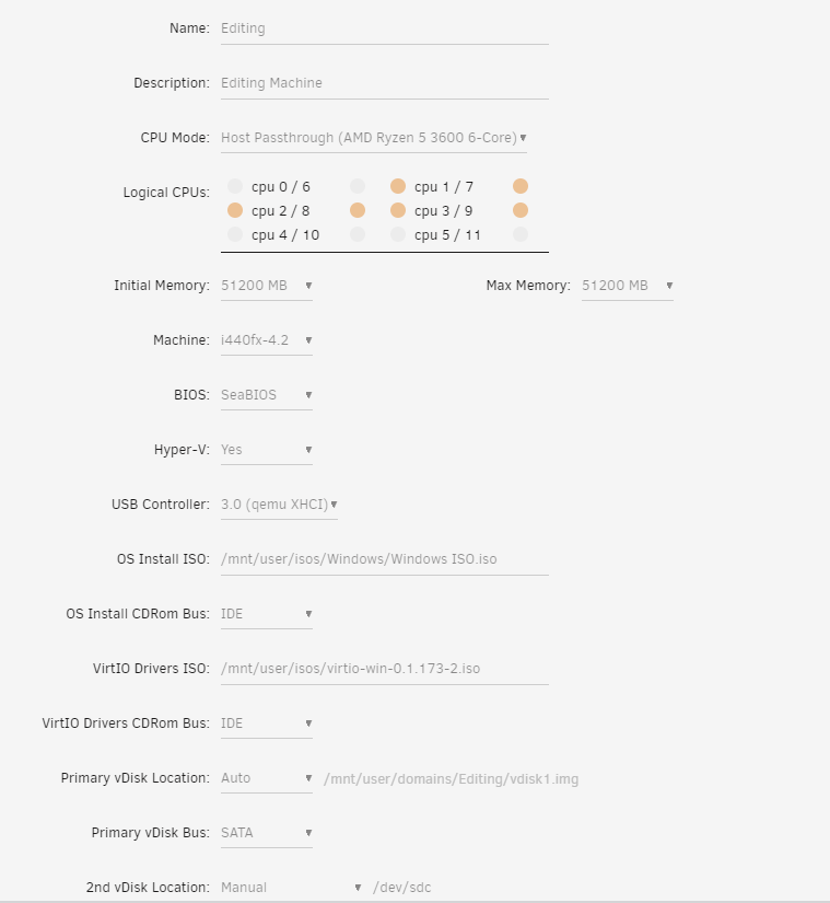

For full transparency - These are my VM settings...
Ideally, I want to pass through the nvme drive and use that as the drive that holds WIN, all programs and cache. But when changing primary vDisk Location to 'none' it is taking the HDD's as bootdrive - which doesn't work.  In the other VM, passing through the nvme drive, it works great, but then I can't see the HDD's anymore.
I would also like to change 2nd and 3rd vdisk locations to have them /by-id/, so I don't loose them..

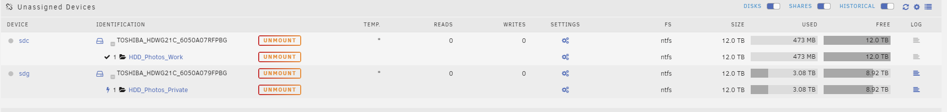

And yes, I am using the Unassigned devices plugin (funny that I have copied over about 3 TB of files on the HDD_Photos_Work and it says 473MB used and it is empty when checking in my VM, HDD_Photos_Private says 3.08TB here too, in the VM, I can see the same, but I cannot see the files - just "Backup") I copied the files over from my desktop HDD's to the unRAID UD HDD's via a network share I setup :
