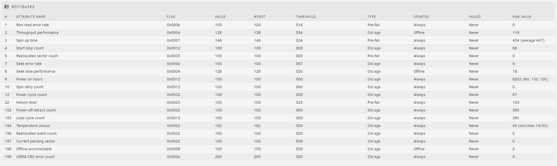

Randomly had a write failure leading to this drive being disabled. New and first unraid build. Was messing around on a VM, unplugged a pass through USB device and this happened. Could have been a coincidence, maybe not?
Drive is only 9 months old. My other 3 drives threw up warnings at the same time, should have taken a screen shot but didnt. I think they were write warnings? Would that make sense?
Ive done a few short SMART tests since this happened and they all come back okay. a Long test says it will take 17 hours. Should I just try and rebuild with the same disk or replace to be safe?
It's already using a new SATA cable, but it is a cheapy off Amazon
SMART looks fine but full diags might give more clues.
