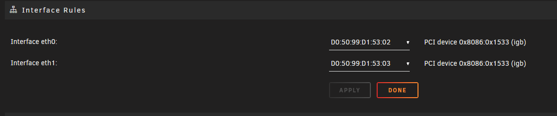

If what you are really trying to accomplish is to make the 10Gb your default connection for unRAID, you need to make sure it is eth0.  unRAID will always use eth0.
Under Settings --> Network Settings you can set which NIC is eth0
