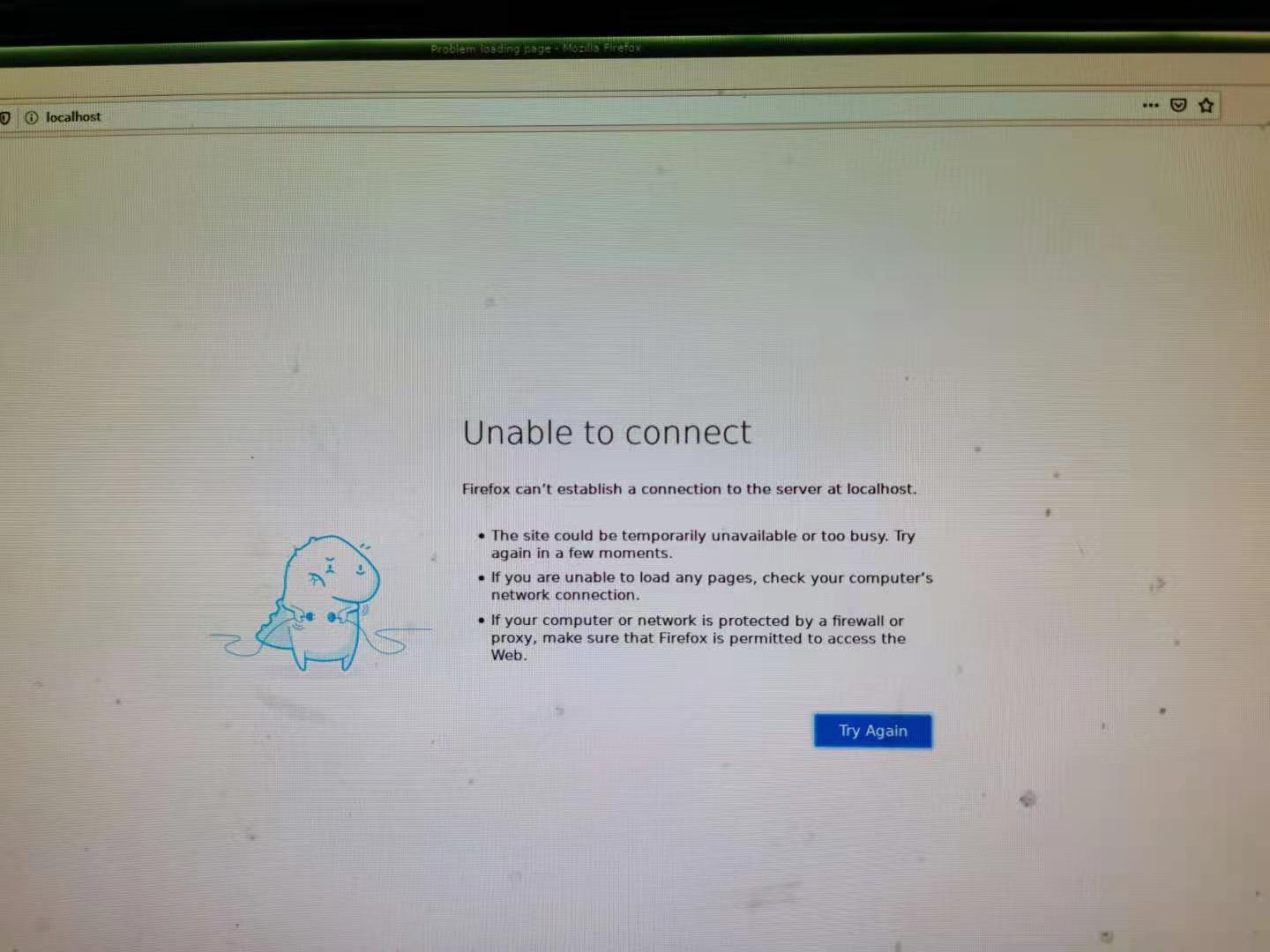

I've tried 6.8.2, 6.8.3 and 6.9, all the same.
Can't connnect to localhost, it's no way to open the tools and download diagnostics.

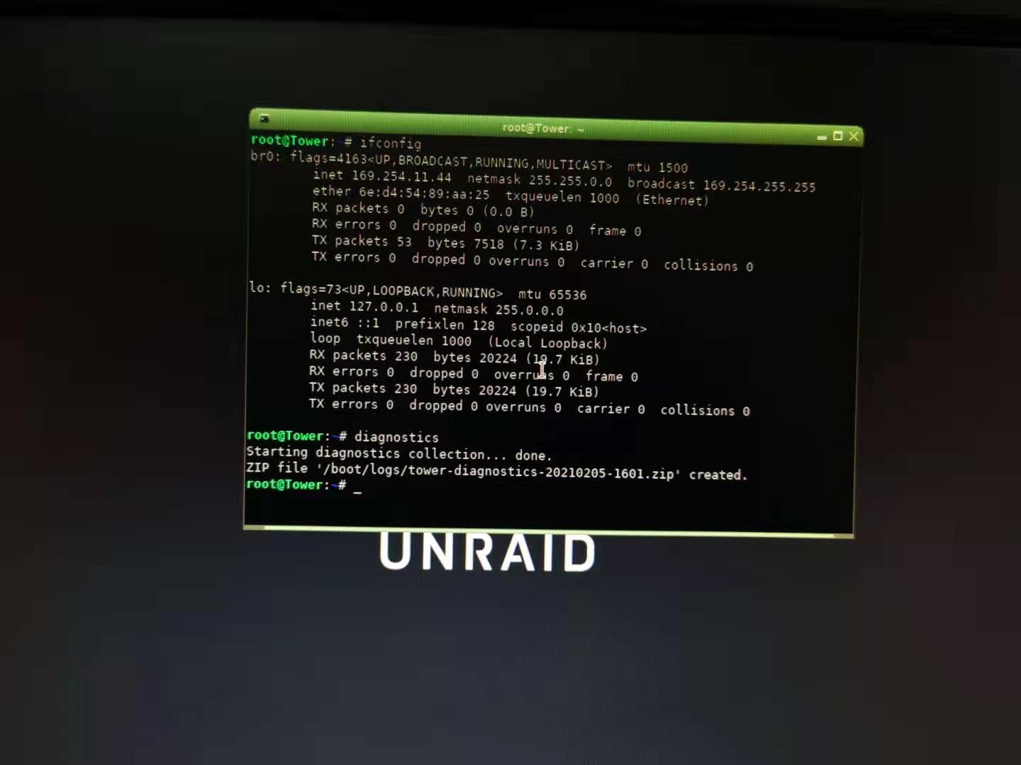

Hi guys, thanks for your reply.
I have tried the command of diagnostics, and got a zip file. Hower, I don't know how to copy it to windows system. There is no such zip file in my flash disk or HDD.

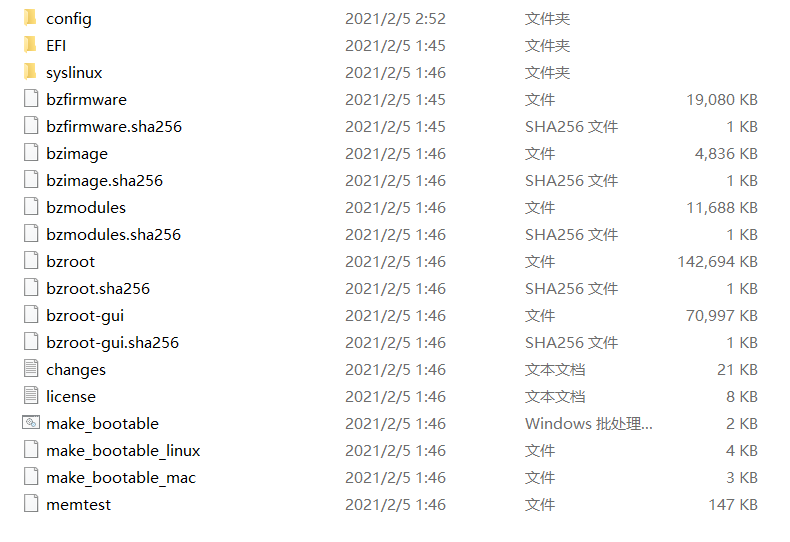

Then plug the flash drive into a PC (the Diagnostics file will be in the   logs   folder/directory of the flash drive)  and copy/upload the file to the forum as an attachment to your next post.
There is no "logs"  folder/directory in my flash drive. No any new file in it.

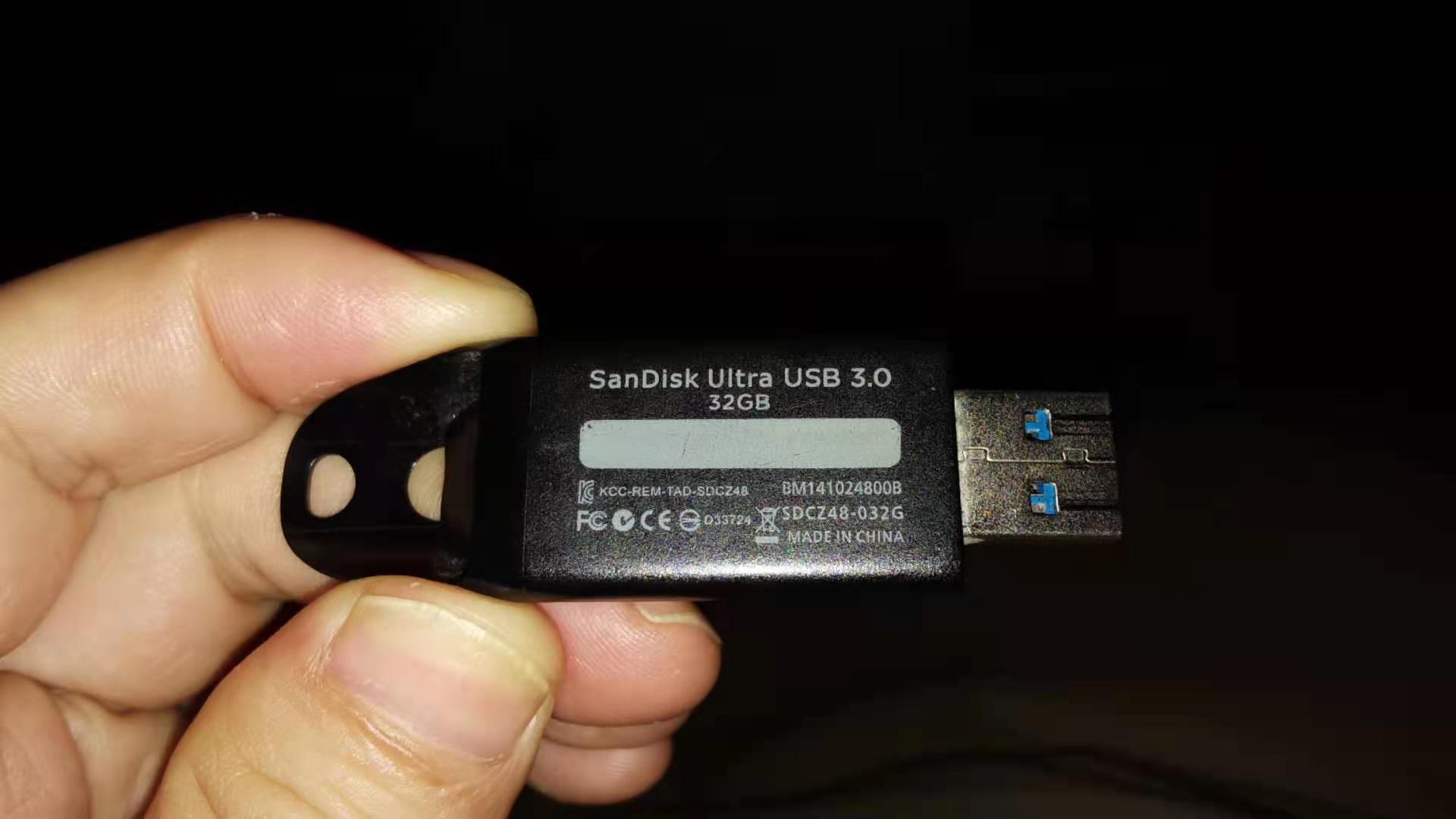

I can boot with that flash drive. Doesn't that mean the flash disk is mounting properly?
Here is my flash disk:

edit
Here is the contents in my flash disk after booting with it and created the diagnostics file.575799216_2021-02-06090927.png.c4b6947f65e9e96d5141cfcf2afbf374.png
No. Booting is the first phase, which copies the base part of Unraid into RAM at /, then the program tries to mount the drive to /boot and read the rest of the configuration. The code that finds and mounts the drive sometimes has a hard time with USB 3.0 on some boards, which is why I suggested playing around with the BIOS options for USB configuration.
That screenshot you showed is what should show up in /boot when Unraid is loaded. I suspect when you navigate to /boot, you won't see any of those files, meaning the flash drive hasn't successfully been attached to that folder.

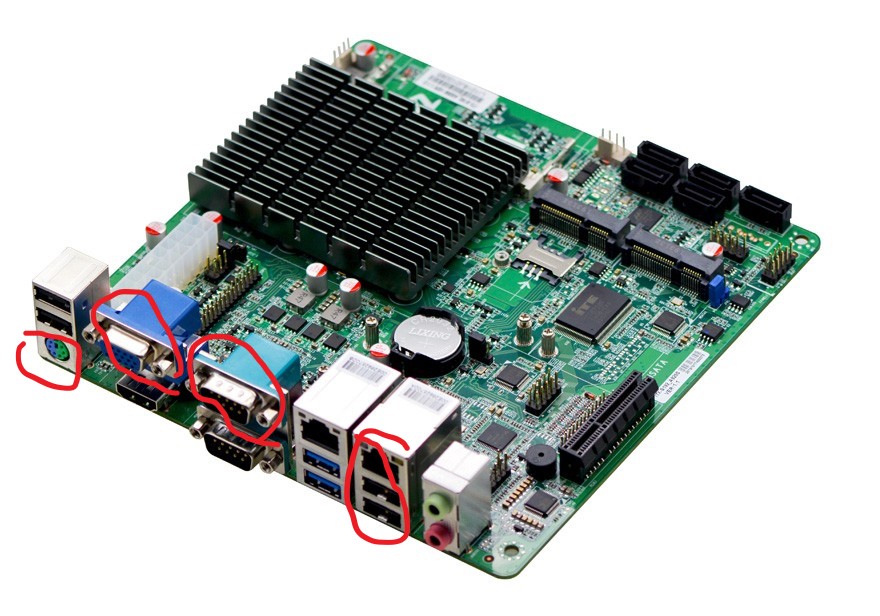

1 hour ago, jonathanm said:
Which motherboard?
Yanyu ITX-K916 motherboard. It looks like the following one:
Hower, my motherboard has fewer interfaces than this one.
The specification is:
♦ Intel® Celeron  J1900/2.00GHz
♦ 1 DDR3LSODIMM RAM Slot
♦ 1 VGA,1*HDMI Interface
♦ 1 Intel I211AT Gigabit Ethernet Card
♦ 1 MINIPCIE
♦ 3 USB2.0, 1 USB3.0
Make sure your boot USB is in a 2.0 port with a black insert.
It's OK now.
I changed a flash disk. Although it's still Sandisk, but is USB 2.0.
Now the IP address is correct.
Thank you!
