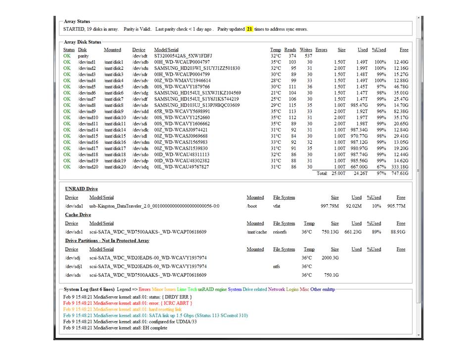

I'm running 4.6 rc5 and attached is a screenshot from unmenu. Thanks for any help.

Determining ata numbers and relating them to the drive numbers has become much harder with recent kernels, especially with the advent of the SAS cards.  They are often scrambled, with no relation to the SCSI ID's.
You should probably not refer to it as ATA8 (capitalized), which refers to a mode or speed of drive communication, ATA8 refers specifically to UDMA/133 (I think).  It should be referred to as ata8 (without the caps) as the syslog does.  As the symbol ata8, it refers to a channel, in this case the channel to one of your port multipliers and the 5 SATA ports on it.  More accurately, the drive you are asking about is connected to/associated with ata8.01, the second drive of the 5 possible drives on ata8, the others being ata8.00, ata8.02, ata8.03, and ata8.04.  This port multiplier set of drives begins with 2 WD20EADS, then an empty port, then 2 WD10EACS, so your drive is the second WD20EADS which is sdj, serial ending in 7974.
But that seems strange as it is the only drive that is NOT in the array, is not even the Cache drive, and therefore cannot be the drive affecting your parity syncs and checks.  I did notice an ICRC in the 6 syslog lines showing in your screen pic, so your first step should be to replace the SATA cable to sdj, then make sure it is well seated in that drive enclosure.
The easiest way to find the clicking bad drive would be to get SMART reports for all of the drives.  An even faster way is to use the MyMain screen of UnMENU, and change to the SMART display, the one that shows critical SMART values, and red-flags any that are serious.  I suspect the bad clicking drive will be very obvious!

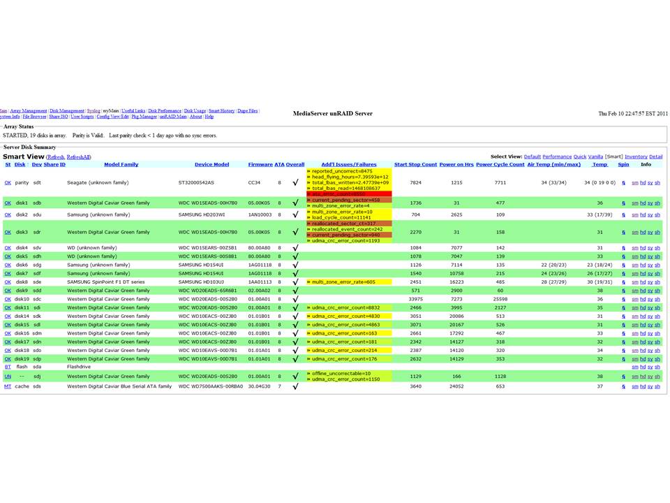

I think I may have done us all a disservice. The ata8 drive is probably not the cause of my bigger problems. The drive ending in 7974 was just put into the port multiplying enclosure for that particular reboot. It was being precleared and put into service as disk 12, to replace one of the missing drives. I've learned a lot from your analysis of the syslog.
Doing what you suggested in ummenu seems to show that the parity drive itself is the worst of the bunch. It's just a few weeks old, but it's one of the problematic Seagates which need a firmware upgrade.
Included is a screenshot. I'm also not enjoying the dark colour of some of the other drives.

those high counts in udma_crc_error_count looks to me is not normal. Usually high number in this counter signal you have many link reset/timeout. you might want to check out those cables.
