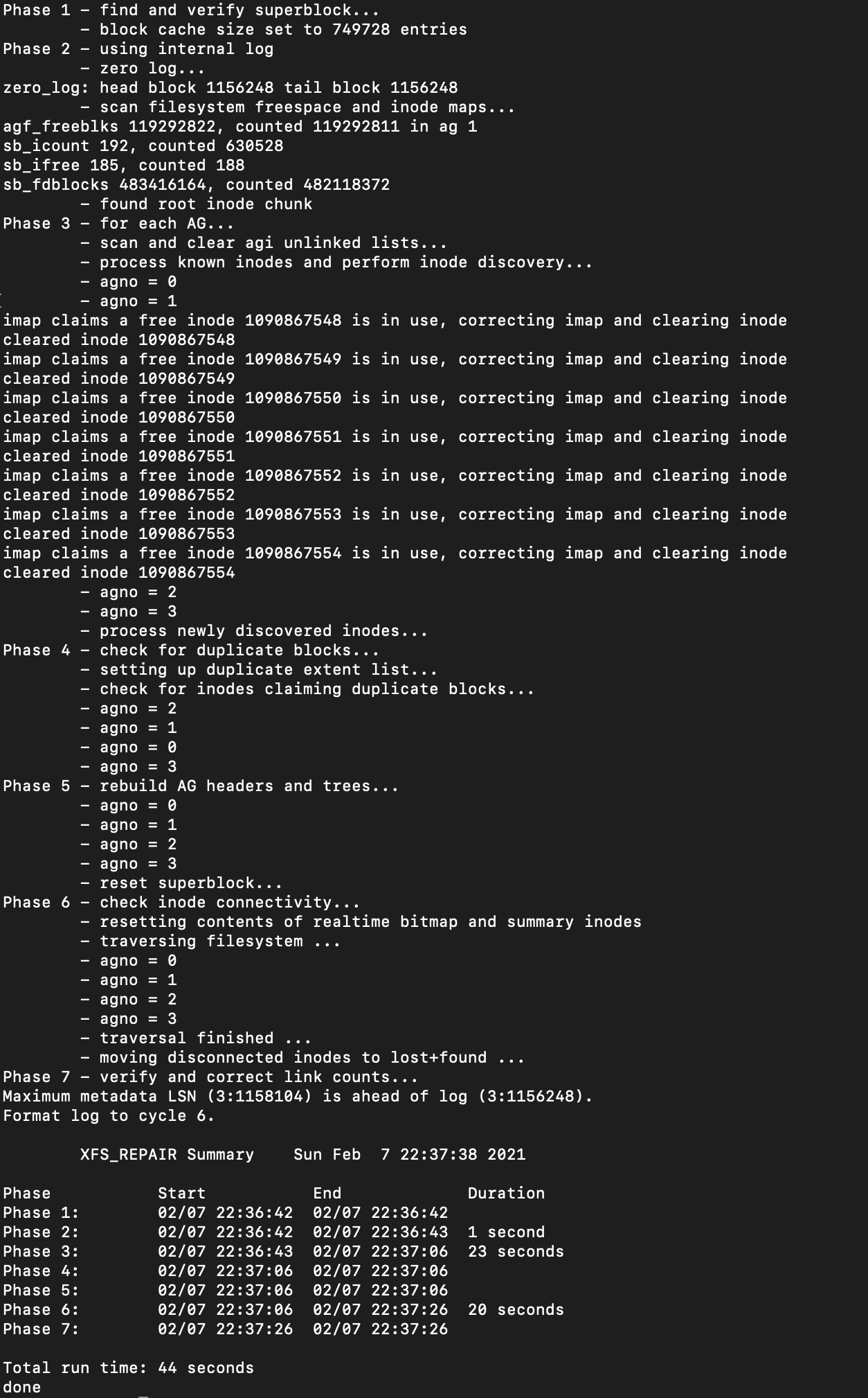

I hadn't, my total mistake.  Read it, performed the check. Not the most experienced in reading it, attach a screenshot or post another diagnostics?
Went ahead and tried to run the repair on telnet.  Phase 1 said bad primary superblock, unable to verify secondary and just kept going and going and going.  Fresh diagnostics here

Exactly what was the command you used?    Did you remember to include the partition number (e.g. something like /dev/sdX1) if using that form of device name.
I ran xfs_repair -v /dev/sdj       I added a 1 to it just now and it ran this time.  Attached a screenshot
If you start the array in normal mode now is cache mounted? Did it put anything in lost+found?
Array started alright. Ill have to locate the lost and found folder and see.
According to those latest diagnostics cache is mounted and nothing was put in lost+found
