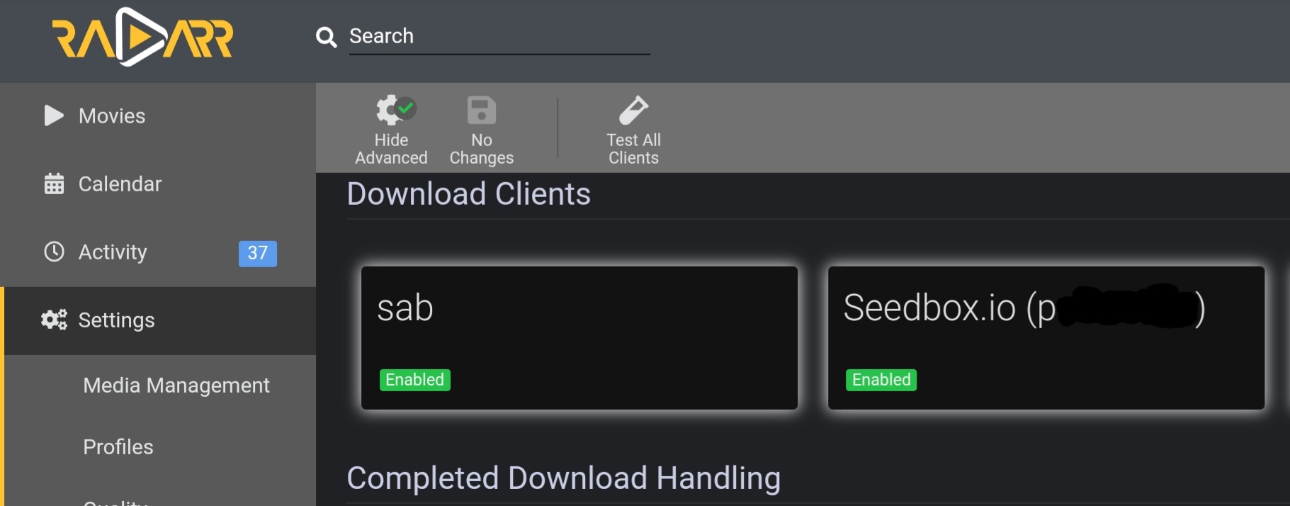

Nzb360 -> Sonarr/Radarr -> Hydra2 (searches NZB via indexes & Torrents via Jackett) -> Sonarr/Radarr -> Sabnzbd/Seedbox.io
I seem to be having an issue with the downloading of torrents. Above is my work flow.
I search for a movie/tv show in Nzb360, which sends the request to either Sonarr or Radarr, that in turn forwards it onto Hydra2. NZB's and Torrents are searched, with the results returned back to Radarr/Sonarr. That then forwards the download (if NZB) onto Sabnzbd, which works great. My issue however is that nothing is being sent to Seedbox.io (if a torrent), even though Jackett is reporting plenty of found releases. I have checked all logs and no apparent issues are present. All connection tests are returning positive.
I'm sure I'm overlooking something simple and have made this process convoluted, however I want to use the seedbox rather than download torrents directly.
Any advice would be greatly appreciated.

Let's start with this... have you followed all the instructions from seedbox.io for connecting sonarr?
https://panel.seedbox.io/index.php?rp=/knowledgebase/41/How-to-connect-Sonarr-to-your-service.html

To be honest that is the exact guide I followed to link both Radarr and Sonarr to Seedbox.io;

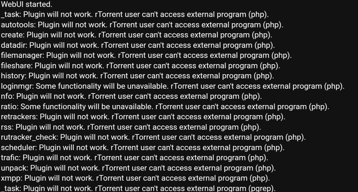

Many thanks, I'll give that endpoint a try.
Unfortunately I had to revert the plugin to the previous setting as it threw up errors during the night.
