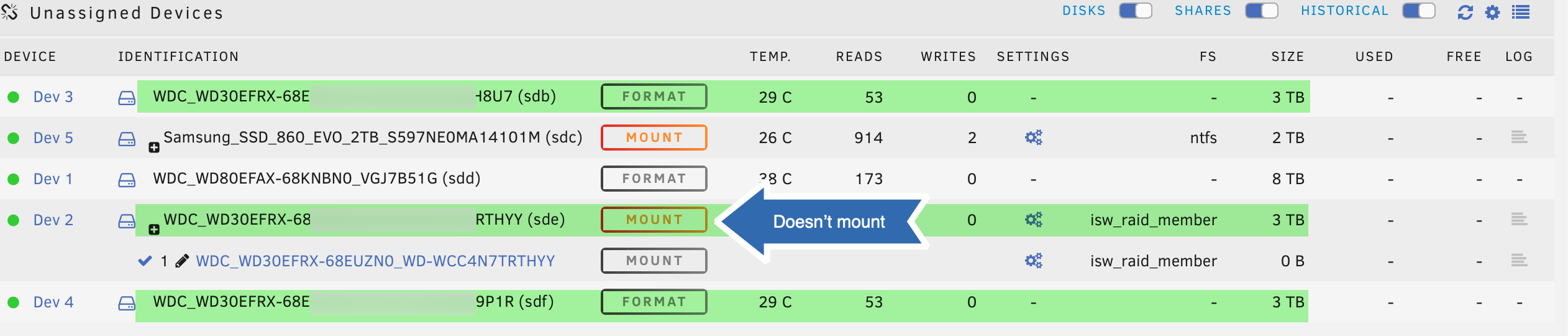

So I tried this, first with an UEFI ArchLinux boot USB to verify I could still mount and access the data on my RAID 5 set okay (I could), and then booting 6.9.0-rc2 (created with the Unraid USB Creator with UEFI checked) on the same USB port. The Intel RST status on the BIOS screen showed everything green, but when I got into the UD settings, I got this (with the green highlighting the three drives in the RAID 5 set):
They showed up as separate drives (which, in itself, isn't necessary worrying, since ArchLinux sees them as four drives, each of the 3 raw 3TB disks, and then the 6TB logical disk), but only for the raw disks, not the RAID set. Only the one marked even had a "Mount" button, and it didn't work. The log messages were:
Feb 14 10:20:03 NAS unassigned.devices: Adding disk '/dev/sde1'...
Feb 14 10:20:03 NAS unassigned.devices: Mount drive command: /sbin/mount -t isw_raid_member -o rw,auto,async,noatime,nodiratime '/dev/sde1' '/mnt/disks/WDC_WD30EFRX-68E************RTHYY'
Feb 14 10:20:03 NAS unassigned.devices: Mount of '/dev/sde1' failed. Error message: mount: /mnt/disks/WDC_WD30EFRX-68E************RTHYY: unknown filesystem type 'isw_raid_member'.
Feb 14 10:20:03 NAS unassigned.devices: Partition 'WDC_WD30EFRX-68E************RTHYY' cannot be mounted.
I went into the Linux console and checked, and unlike on Arch Linux where you can find these under /dev/md*, no /dev/md* devices exist on Unraid. Do I need to pass some kernel boot options or something?
You will need to keep Unraid from seeing and trying to access the disks you want to mount. Set up a VM and pass through those disks so you can deal with them there.
Thanks, that makes sense, but following the guide for 6.9, I went to Tools → System Devices, and all my disks—my array disks and these Intel RST disks—are in the same IOMMU group. Which makes sense, as I don’t have a separate storage card but the built-in mobo one.
So how does one go about hiding devices rather than the entire IOMMU group?
On the UD line item for the disks in question, click on the settings (three gears) and select the passthrough option.
Thanks, but if you look at the screen grab above, only one of the three 3 TB drives has the gear icon—what do I do about the other two?
Those drives without the icon aren't being intercepted by UD, so those can be passed through normally without changing any settings.
