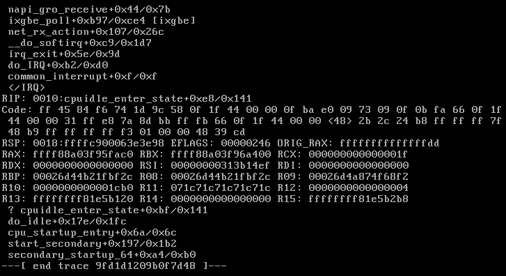

[6.8.3] My Unraid server does this (crashes?) every so often, anyone know what's going on?
Last time, it took 20+ days, this time, 4-5-ish days. Can't access shares or the web interface.  I have to hard reset via IPMI and then parity check runs, 0 errors.
The dockers I have running are Plex, Locast2Plex, Glances, and binhex-krusader. No VMs. I wasn't even home when the server went weird.
I think it might have something to do with Locast2Plex (host with its own IP) but stopping it off for a long time didn't do anything.
Anyone have any insight?

You can try this and then post that log, as well the complete diagnostics.
I enabled syslog, here's an entire snip of the kernel panic.  But the server is not crashed or hung up.  Nothing prompted me to grab this log, I was just curious what it said at this hour.  I also see the BTRFS critical errors, but no SMART errors on any drives.
syslog-10.0.10.x-5.txt
serverone-diagnostics-20210206-0039.zip
Edited by Gbcue
Btrfs errors are likely the result of the previous crashes, I don't know how critical that particular error is, but it might be a good idea to re-format the pool just in case.
Your main issue is likely related to the macvlan call traces, these are usually the result of having dockers with a custom IP address, and may end up crashing Unraid, see below for more info.
Thanks, it seemed like setting a VLAN with custom IPs solved my issue.  Can you point me to more info on reformatting my cache pool?
