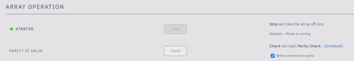

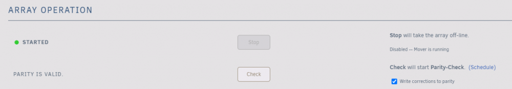

I cannot stop the array since the mover is running, but presumably the mover will never finish now due to the cache disk being full...

I don't see an obvious way of stopping the mover, I don't suppose rebooting the server (through the web interface) is a good idea.

Ok, turning off Docker made my server completely idle now, all disks have spun down. It still says the mover is running but this is clearly a lie. 😮
What can I do now? Reboot? (through the UI, not a hard reset)
