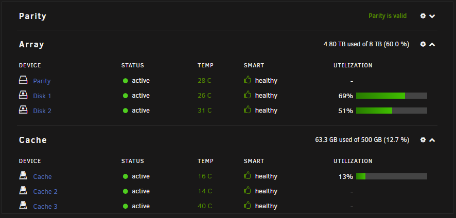

My disks and cache has lots of space:

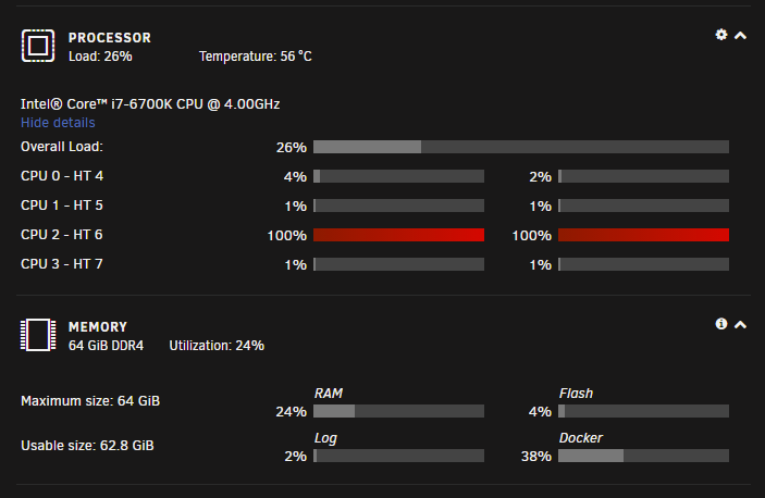

And so has my CPU, RAM, Log etc:
(The 2 CPU in RED is the Ubuntu VM)

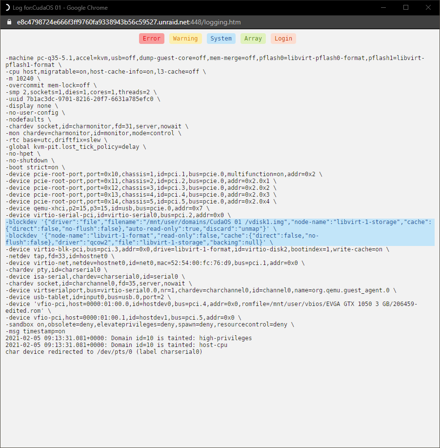

And the Log for the VM does not give my any hints:
-machine pc-q35-5.1,accel=kvm,usb=off,dump-guest-core=off,mem-merge=off,pflash0=libvirt-pflash0-format,pflash1=libvirt-pflash1-format \
-cpu host,migratable=on,host-cache-info=on,l3-cache=off \
-m 10240 \
-overcommit mem-lock=off \
-smp 2,sockets=1,dies=1,cores=1,threads=2 \
-uuid 7b1ac3dc-9701-8216-20f7-6631a785efc0 \
-display none \
-no-user-config \
-nodefaults \
-chardev socket,id=charmonitor,fd=31,server,nowait \
-mon chardev=charmonitor,id=monitor,mode=control \
-rtc base=utc,driftfix=slew \
-global kvm-pit.lost_tick_policy=delay \
-no-hpet \
-no-shutdown \
-boot strict=on \
-device pcie-root-port,port=0x10,chassis=1,id=pci.1,bus=pcie.0,multifunction=on,addr=0x2 \
-device pcie-root-port,port=0x11,chassis=2,id=pci.2,bus=pcie.0,addr=0x2.0x1 \
-device pcie-root-port,port=0x12,chassis=3,id=pci.3,bus=pcie.0,addr=0x2.0x2 \
-device pcie-root-port,port=0x13,chassis=4,id=pci.4,bus=pcie.0,addr=0x2.0x3 \
-device pcie-root-port,port=0x14,chassis=5,id=pci.5,bus=pcie.0,addr=0x2.0x4 \
-device qemu-xhci,p2=15,p3=15,id=usb,bus=pcie.0,addr=0x7 \
-device virtio-serial-pci,id=virtio-serial0,bus=pci.2,addr=0x0 \
-blockdev '{"driver":"file","filename":"/mnt/user/domains/CudaOS 01 /vdisk1.img","node-name":"libvirt-1-storage","cache":{"direct":false,"no-flush":false},"auto-read-only":true,"discard":"unmap"}' \
-blockdev '{"node-name":"libvirt-1-format","read-only":false,"cache":{"direct":false,"no-flush":false},"driver":"qcow2","file":"libvirt-1-storage","backing":null}' \
-device virtio-blk-pci,bus=pci.3,addr=0x0,drive=libvirt-1-format,id=virtio-disk2,bootindex=1,write-cache=on \
-netdev tap,fd=33,id=hostnet0 \
-device virtio-net,netdev=hostnet0,id=net0,mac=52:54:00:fc:76:d9,bus=pci.1,addr=0x0 \
-chardev pty,id=charserial0 \
-device isa-serial,chardev=charserial0,id=serial0 \
-chardev socket,id=charchannel0,fd=35,server,nowait \
-device virtserialport,bus=virtio-serial0.0,nr=1,chardev=charchannel0,id=channel0,name=org.qemu.guest_agent.0 \
-device usb-tablet,id=input0,bus=usb.0,port=2 \
-device 'vfio-pci,host=0000:01:00.0,id=hostdev0,bus=pci.4,addr=0x0,romfile=/mnt/user/vbios/EVGA GTX 1050 3 GB/206459-edited.rom' \
-device vfio-pci,host=0000:01:00.1,id=hostdev1,bus=pci.5,addr=0x0 \
-sandbox on,obsolete=deny,elevateprivileges=deny,spawn=deny,resourcecontrol=deny \
-msg timestamp=on
2021-02-05 09:13:31.081+0000: Domain id=10 is tainted: high-privileges
2021-02-05 09:13:31.081+0000: Domain id=10 is tainted: host-cpu
char device redirected to /dev/pts/0 (label charserial0)
