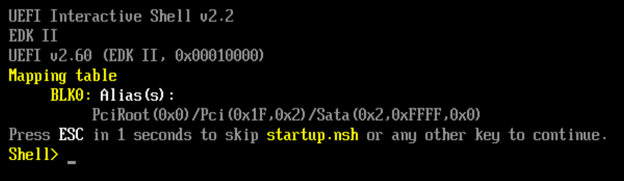

February 9, 20215 yr Author Well, I feel a bit sheepish. On my setup, it looks like libvirt can't mount images from anywhere other than /mnt/user. I copied the same image to shares on /mnt/cache and mnt/disk*, and none of those work. I just get the UEFI Interactive Shell and BLK0: in the Mapping Table. Either that and/or it doesn't like you changing the location of an image once the VM has been created. Not sure. I created a new VM, used the original image in /mnt/user... and it booted right up. So much time spent on figuring that out. Ugh. 11 hours ago, Vr2Io said: Always backup image in HA self, this always work and save lot of time. Yeah, I think this is the most reasonable option at this point. I originally thought taking snapshots of the entire VM once a night would be simplest, and it turned out not to be. I'm going to explore automated backups from within HA. Thanks!
September 2, 20215 yr im having the exact problem but trying to boot my qcow2 image from /mnt/user/domain doesnt work either. i moved mine from default cache location to /mnt/disk2/domains/ and now wont boot with the interactive shell error.
December 30, 20214 yr Just got this error when i tried to move the qcow2 image to a different folder. The reason for this error is because unraid for some weird reason changes the type from "ucow2" to "raw" (in the xml). Change this back to "ucow2" and it should boot as normal (atleast it did for me). Quote <emulator>/usr/local/sbin/qemu</emulator> <disk type='file' device='disk'> <driver name='qemu' type='raw' cache='writeback'/> <source file='/mnt/user/domains/ha/ha.qcow2' index='1'/> change to this: <emulator>/usr/local/sbin/qemu</emulator> <disk type='file' device='disk'> <driver name='qemu' type='qcow2' cache='writeback'/> <source file='/mnt/user/domains/ha/ha.qcow2' index='1'/> Edited December 30, 20214 yr by alpha

March 26, 20224 yr Bitten by the same issue of non-booting (though not trying to make a backup). Problem/fix compounded by not being able to shut down the VM instance while it was stuck in the UEFI Shell - so no ability to edit the XML. Waiting on the whole system to come back after trying to reboot the server via Unraid menu. EDIT. Serious scare when the system came back up. NVMe cache drive holding all VMs didn't show up and made all VMs complete inaccessible. Shut-down and reboot brought it back and everything was as expected. Including the problem VM which was currently set to qcow2 instead of raw disk type. I didn't manually change anything, it just showed up again like it had always been. The entire fiasco is strange. Edited March 26, 20224 yr by Espressomatic
May 28, 20224 yr I was having this exact same issue but on a brand new VM with a fresh HASSOS qcow2 file (straight from Home Assistant's website) and couldn't for the life of me figure out why it wouldn't boot (since past UEFI boot issues have been due to Home Assistant OS updates breaking its own boot files but this was a fresh image file). I checked the XML view and sure enough it was set to raw instead of qcow2 for some reason. I changed that and it boots up just fine. I wonder what is causing unRAID to pick the wrong disk type.

July 30, 20224 yr So I've been trying to get Homeassistant VM going, and even tried a Windows VM to get going and was having the same issue above. I go to XML, and it shows RAW, but I change it as instructed and update and it still doesn't load. So I go to check it again, and it shows its raw again, for some reason its now staying udpated. Any recommendations?
