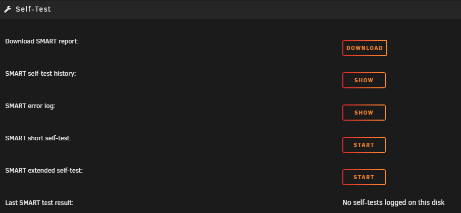

I clicked both of the SMART self-test buttons for that drive when it was part of the array and neither did anything...the log and history and all that didn't do anything other than tell me to use a command and that command...well...I didn't really feel like going down that rabbit hole at the time...
Are the logs stored somewhere?  It runs these tests automatically periodically, doesn't it?

Aww...the diagnostics aren't going to work.  Disk3 is gone...I've been messing with it.  Shoulda pulled these as soon as I noticed an issue.  I'll remember that in the future...
All the files in the "smart" folder show the same stupid thing I was seeing earlier, though.  It just says to run a command.  That normal?
