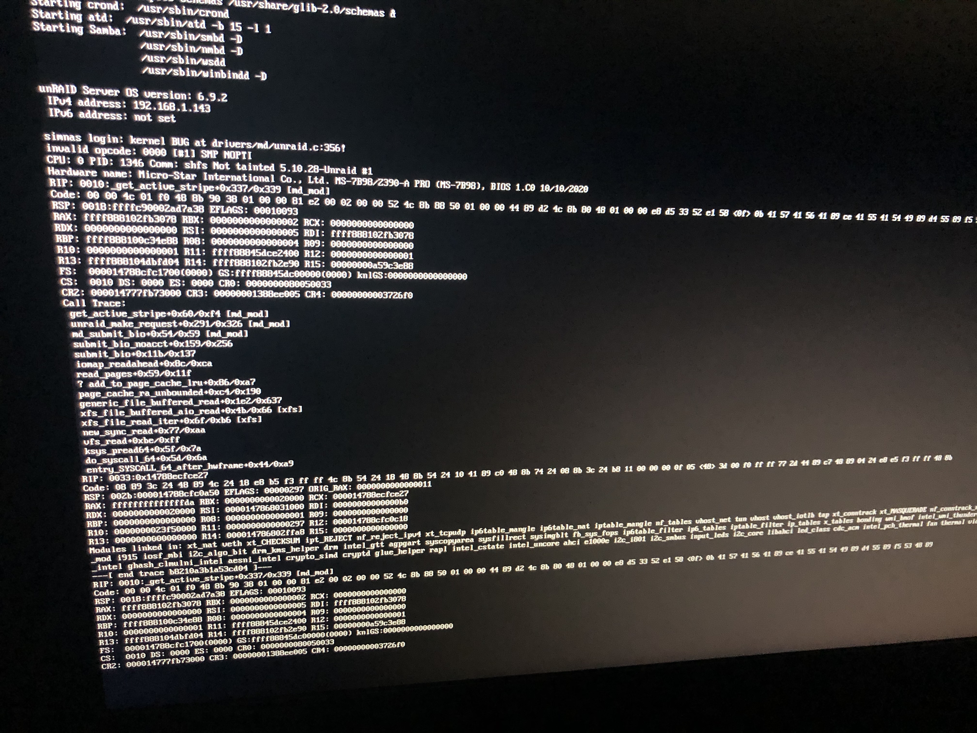

Now that i have a screen connected I was able to take a screenshot of the trace when it went unresponsive.
simnas-diagnostics-20210626-1319.zip HardwareProfile.txt
That's the Unraid driver crashing, there's a different SMB related crash in the log, still looks like hardware related issue to me.
This is all brand new hardware so happy to try and troubleshoot it. How do we go about that?
