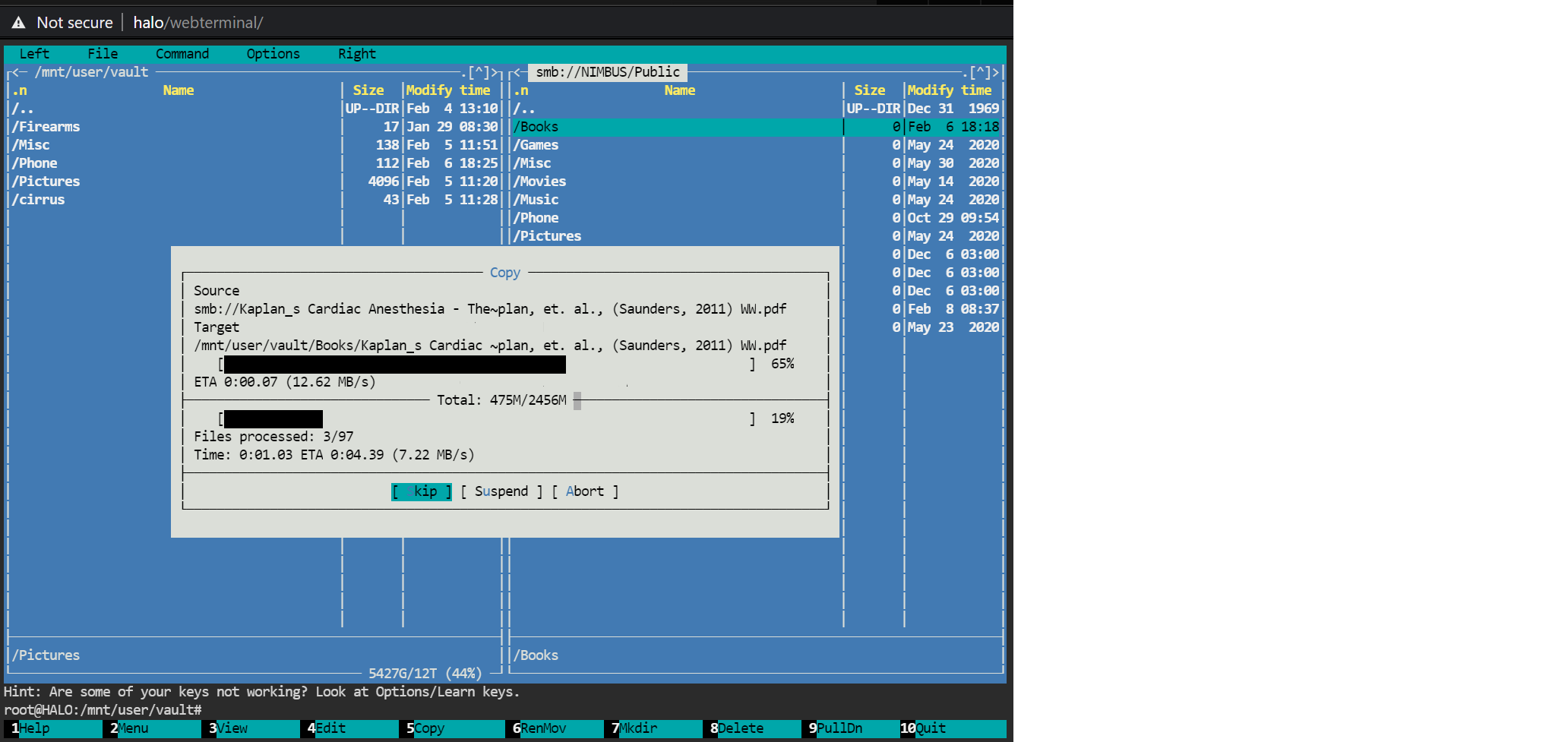

Did you try to make the same transfer with Midnight Commander ? (mc in the console)
Thank you for your responses so far.
I had not looked into MC. After learning about it, I managed to create a connection between my UNRAID server and my PR4100 and had the same slow speeds as with the krusader GUI! Photo attached.

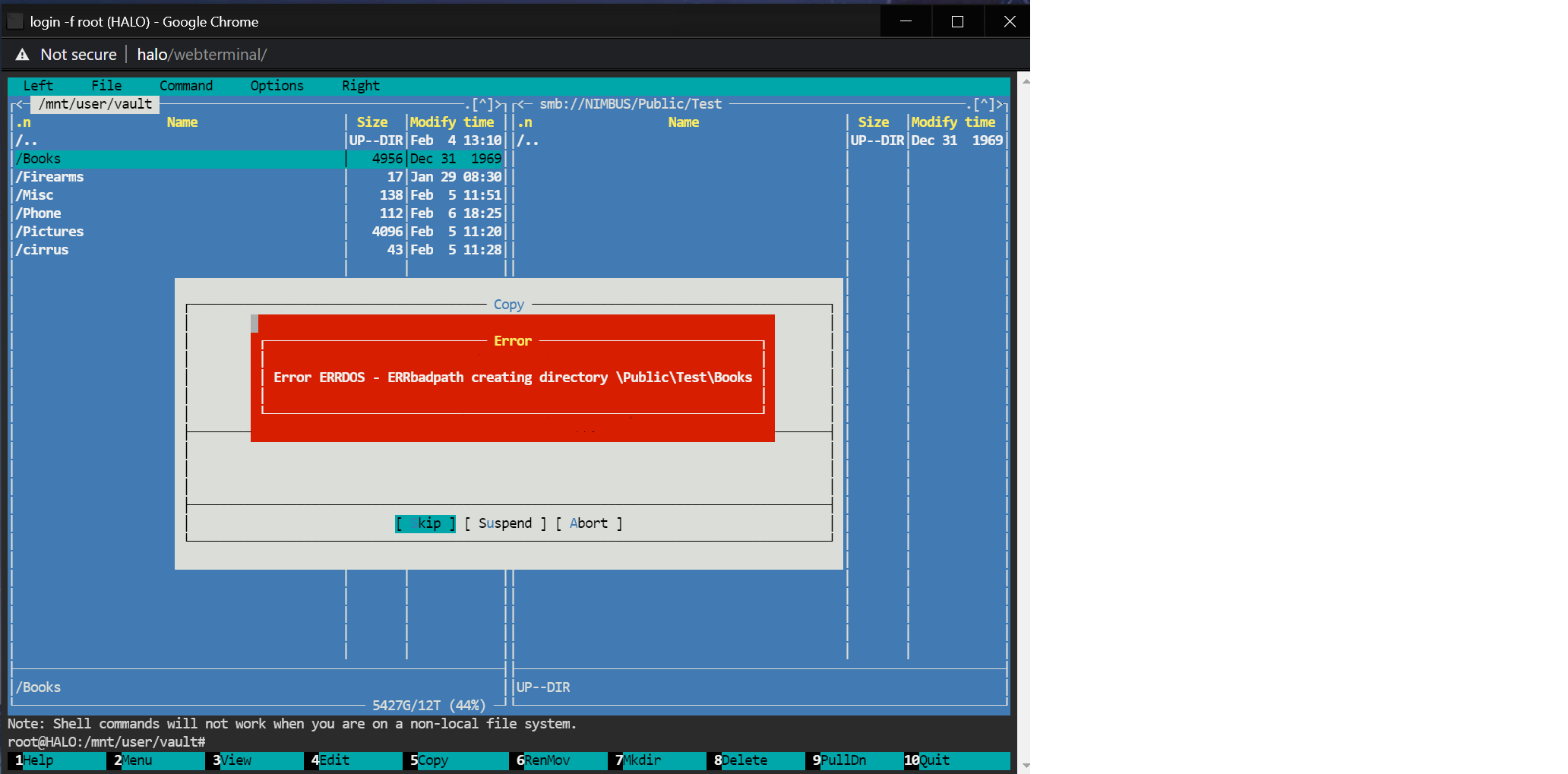

I would also receive an error when writing UNRAID -> PR4100 " Error ERRDOS - ERRbadpath creating directory \Public\Test\Books" for example - however transfer speed is still my biggest issue at the moment.

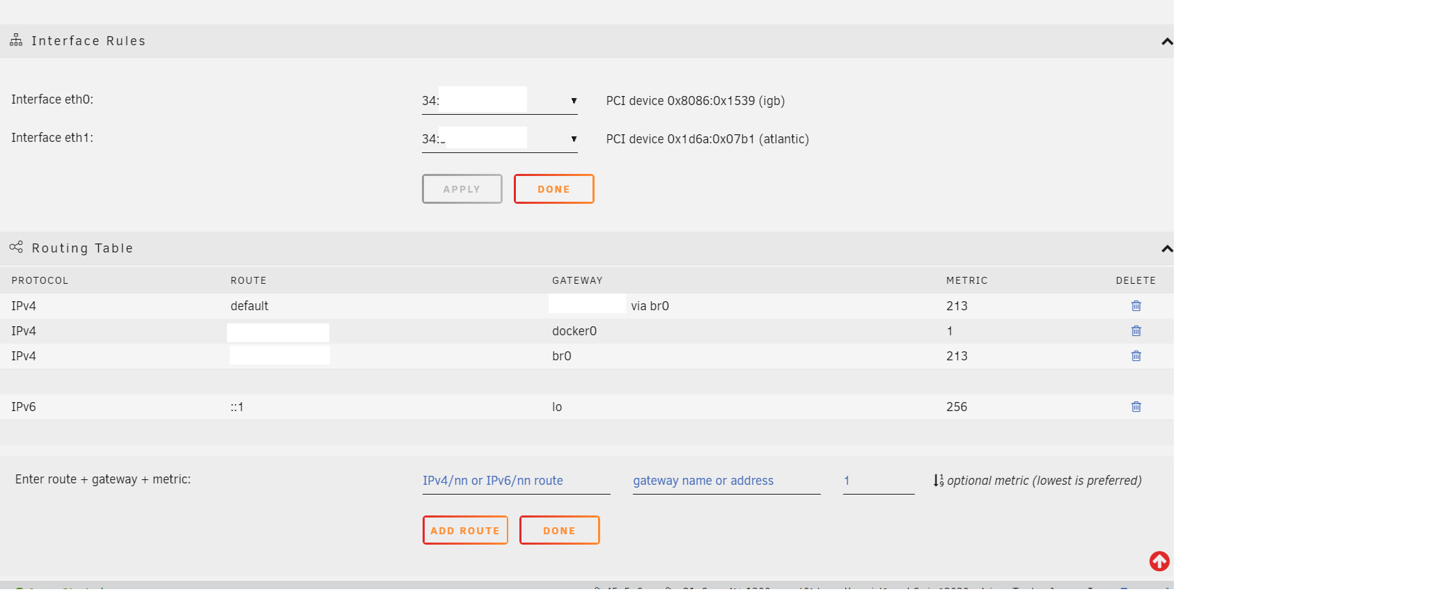

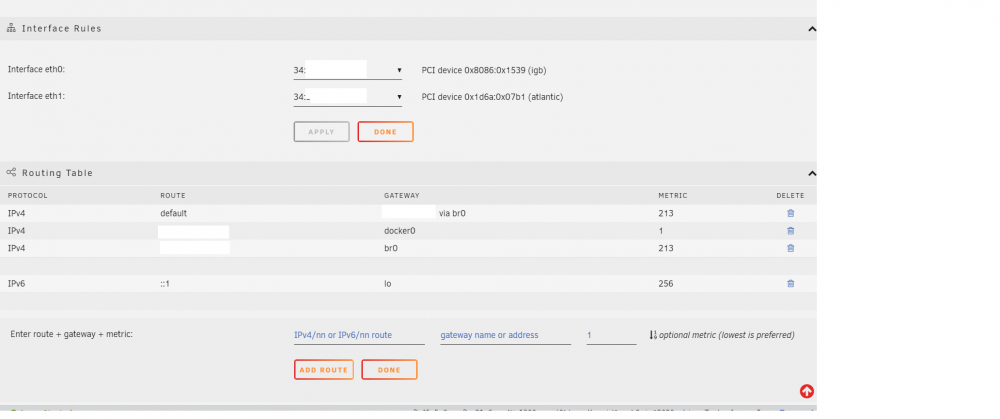

I'm beginning to wonder if it is something with my network settings ie something wrong with my routing table. Unfortunately I know very little about networking and I am worried I would brick access to my unraid web UI.

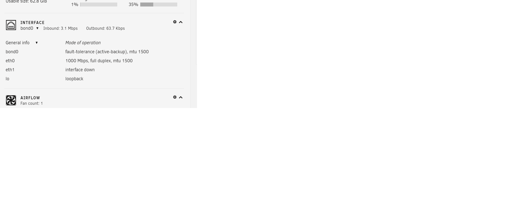

I've attached the noted speeds under interface as well as a screen of my network settings.
Seems that bond0 is "fault-tolerance"
eth0 is GB
eth1 down?
