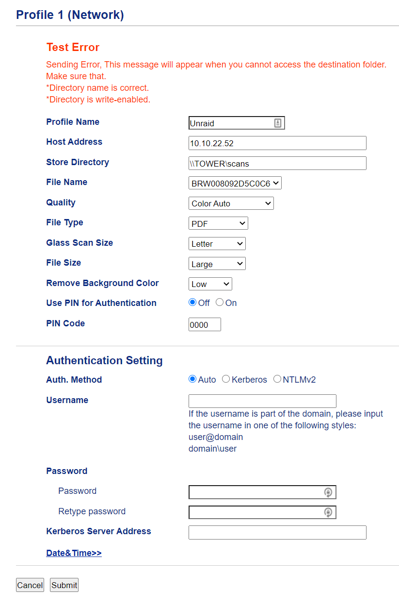

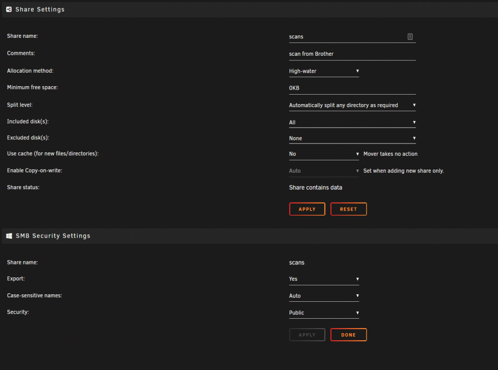

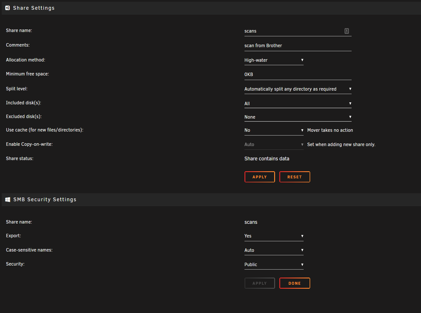

I have unsuccess been trying to set up a profile to scan from my Brother MFC-L8850CDW to an Unraid share. Does anybody have experience with it?
I've tried every combo of host address and store directory I can thing of, with and without a username and password.
image.thumb.png.0ffe8706e7bf608df784e0723b916da1.pngimage.thumb.png.d218639f794f7cd81ecd6f67b88470fe.png
The only thing that I can see is that I would not expect to see  \\TOWER as part of the Store Directory (you have already specified the server via its IP address).   I would expect that field to just contain "scans" assuming that is the name of the share on the Unraid server.
That got it thanks! I tried every combo but just scans.
