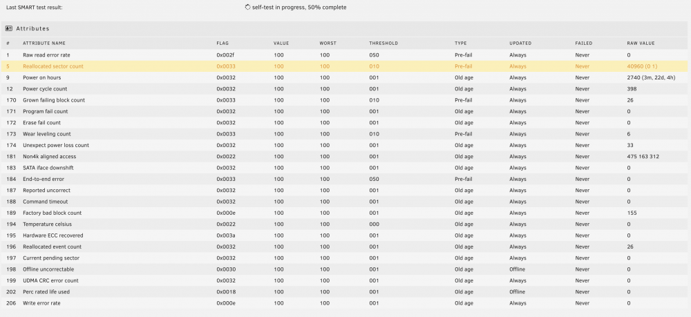

Hi, I have an old Crucial M4 SSD I bought in 2012 I plugged into my computer and was thinking for using it for Plex Metadata storage. Shocker, Unraid thinks its old! Haven't used it regularly in about 6 months, but before that I was using it for backup storage and didn't notice any problems using it then. Think it's fine to use it for that or I should buy a new SSD? I was thinking of doing a backup to my main array if I can figure out how to set that up if it does fail. Any thoughts? Suggestions are most welcome!
The test result "Completed without error" FYI, but still have an error on that No. 5 one.
The yellow line looks more like a warning that the drive reached a pre-fail value, maybe not an error.
