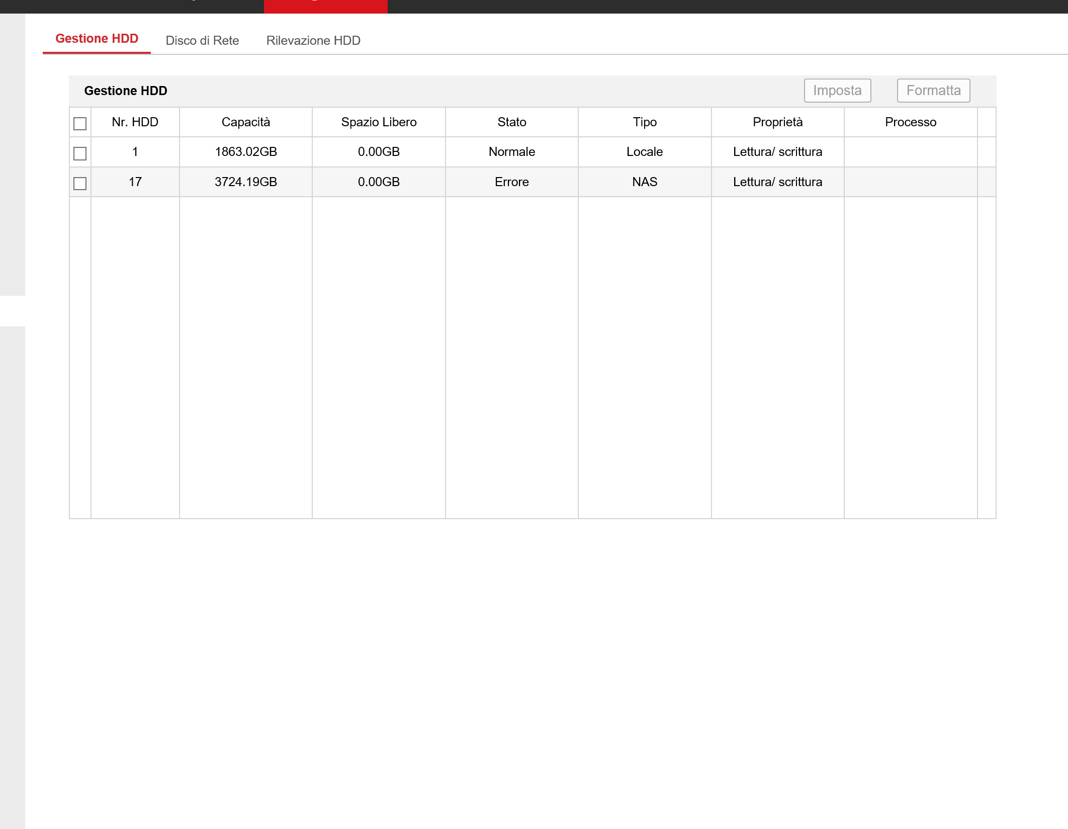

i have a problem with the nfs mount system.
I would like to use nfs for the video surveillance system, as soon as I insert the ip it detects the disk but cannot format it.
the status for the nvr is abnormal.
Thanks for your help
PS my nvr is Hikvision

i have this problem in NVR SETTING

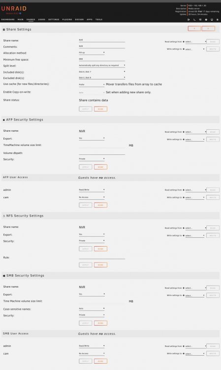

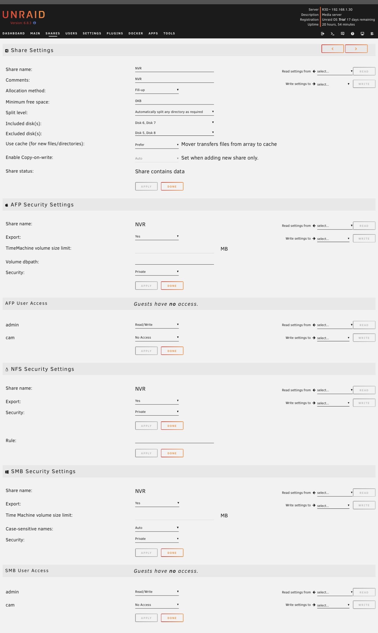

This setting are correct ?
Doesn't look like you have given NFS access to any users.
what are the permission settings?
thanks 🤩

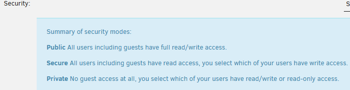

@R3D, the first thing that I suspect is that you have not added any 'users' to your Unraid system.  If you are using either Secure or Private security on any share, you have to have users assigned with passwords.  (The user 'root' is not allowed to have network access to any share for security reasons!)  As I recall, adding a user will trigger an option in each network protocol section (with the Secure or Private setting) to add user(s) with specific access privileges.  Please note that if you using the 'Private' setting on any share, you will have to assure that a user is properly logged into the server before you can have any access to the share.
I don't know how aware you are on security in Linux (or any OS for that matter) so I am taking a bit of liberty and posting up a short explanation of the various Unraid security settings:
Another thing that might help you is the built-in Help system.   You can turn it on toggling the 'Help' icon (a '?' in a circle) on the menu bar near the top of the GUI.
His screenshot seems to indicate users named 'admin' and 'cam'. These users have AFP and SMB access to the share, but no NFS access to the share.
Thank you very much .
i solved it by changing security in PUBLIC
