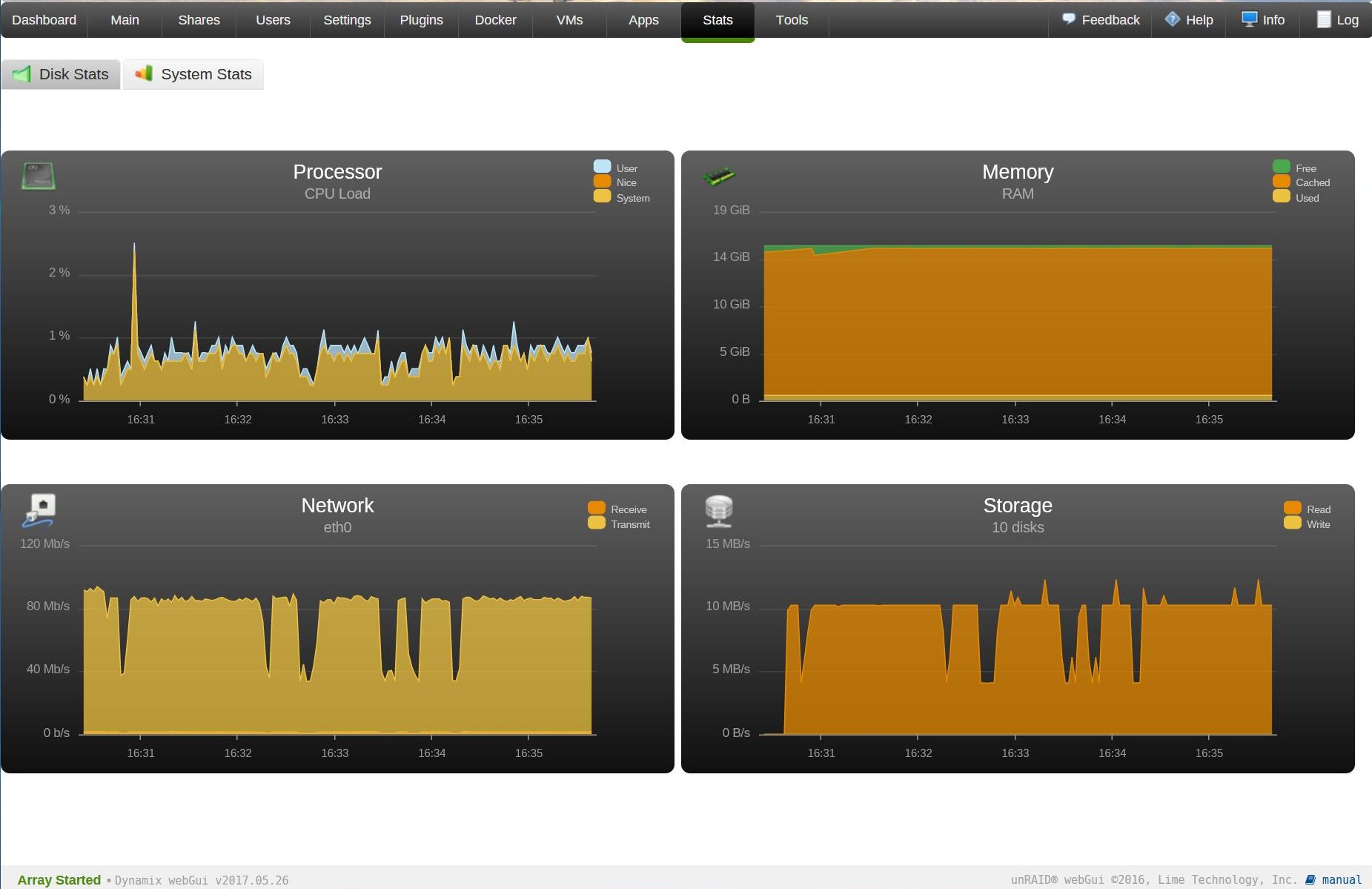

My main PC is in another area of the house, and I have PowerDVD 20 Ultra installed, so I brought up the UnRAID menu, set it to show system stats and started playing it from there - I know this doesn't replicate the issue I saw on the Zappiti, but I'm a little suspicious of some kind of network issue so I thought this would at least give me some information.
Playing back the movie file via PowerDVD did introduce some buffering - especially at the beginning, but after the first minute or so its playback was stable. I captured an image of the UnRAID stats while the file played, and I've attached that here. I'd like to know if these stats are 'reasonable' - i.e. is this a problem, or should I look elsewhere.

Is it normal that your network is only at 100Mbps ?
Your board is capable of 1000Mbps.

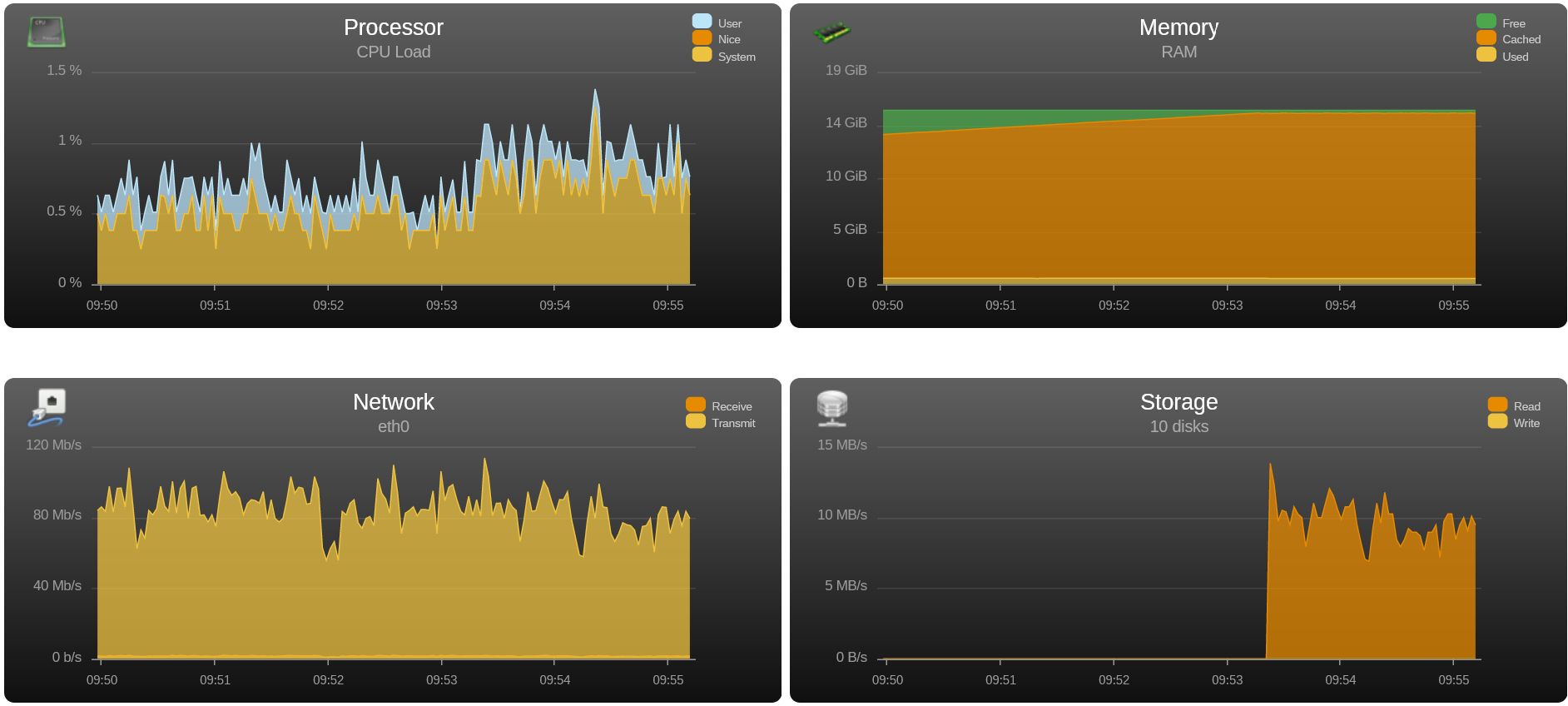

Out where the UnRAID server is I have a Linksys 16 port switch with a number of spare ports, so I tried a different port - no change. I had a couple of spare cat6 cables in the office, so I opened one and switched out the cable. Initially nothing happened, but then the yellow LED lit up on the switch to indicate a gigabit connection, and the lan port on the server also glowed a different color.
So, I pulled up the system stats page on UnRAID, went out to the lounge and fired up the FOTR movie again - I got past the earlier failure point without any problems, and gave up after 25 minutes - it was rock-solid stable.
I also took a picture of the stats shown by UnRAID, and I think they tell an interesting picture...
What can be seen now is - the network transmit graph shows peaks as high as, say, 110 Mb/s - whereas - in the earlier picture - it looked like the transmit was hitting a ceiling of about 90 Mb/s.
I believe this has SOLVED the issue. I'd be seriously embarrassed, but I'm too busy being relieved.
